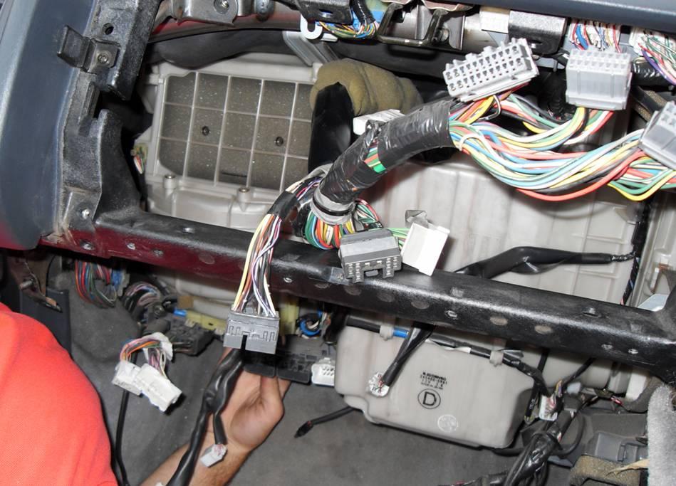

    hi all i have been cotemplating this for a long time and after picking up a J reg LS400 for £300 its time to do it! i have been on lextreme web site very helpful for this particular project and have got lots of useful information wiring diagrams etc from the site so i am starting the swap now. if it all goes good i will do a write up and post lots of pics. if it doesnt i will have two cars to brake and sell spares!
    the plan in a nut shell is to take the engine torque converter bell housing and gear box from the Lexus so the ECU can run the engine and gear box and attach the gear box to the transfer case and hopefully keeping high and low range and 4WD
    it has to be done fairly quickly as she wants all cars off the drive so there is more motivation (nagging to get it done) than a woman!
    the pic attached is the ECU just for the engine and gear box!

        yeah i have seen some of the pics of his conversion and am hopefully expecting him to see the thread and offer some advice! i have a lot of info from our aussie and NZ friends who seem to do this on a daily basis the wiring is the biggest head as well as everything else! but i am going to use the engine bell housing torque convertor and gear box from the lexus so should be a little easier than connecting to thte surf because it seems that it doesnt work properly and doesnt change down gear.
        as a bonus i would love to take the parking brake form the lexus as it is pretty cool!
        will be atempting the wiring this week and next just clearing some space in the lexus at the moment!

              yeah i have that manual in full colour the engine ECU is 8 pages wide in colour wiring diagram!!! i have spend all week and more on the computer researching and getting the info together! the 1st thing is getting your head around what is needed as this is the hardest swap a 2WD petrol into a 4WD diesel. it will be fully documented with a full range of language and facial expressions to accompany it!

                    If you get "really" stuck with the looms. Speak to Rogue Systems. A chap there (Lyndon I think) is a dab hand at the V8.
                    He did the Thor 1UZ Supra, and my mates mk2 .. using a link ECU.
                      if the lex' has a separate engine loom your laughin, all you'll need is power to the ECU.
                      I dare say there will be lots of 'bits' you wont have to bother with like ABS, traction control, cruise control etc..if is all controlled by the same ECU..??
                      Ive done a few projects, i built an ECU from the board up for my old S2 turbo & mapped it, no where near as complex as a factory toyota, but principals are the same..not too bad once you get your head tuned into it
                        the Lex ECU does the engine and gear box and thats what i will be putting in to the surf and bolting the transfer case on the end. the lex shaft out the gear box is a little longer than the surf gear box but can be 'cut' to right length by a fabricator so it will fit into the transfer case.
                        have aslo take the combination meter loom out the lex so will try and fit that to the surf dash so will get right revs and speed etc. as also controlled by the lex engine ECU

                          engine and gear box (plus all electrics) are now out! pics and vids at link above
                          now the fun begins!
                          http://www.hiluxsurf.co.uk/showthread.php?t=55797
                            sucessfully taken out the engine & gearbox together and complete engine gearbox combination meter igintion etc wiring loom now to fit to into surf!
                            engine loom
                            [/IMG]
                            combination loom
                            [/IMG]
                            getting it out of the car![/IMG]
