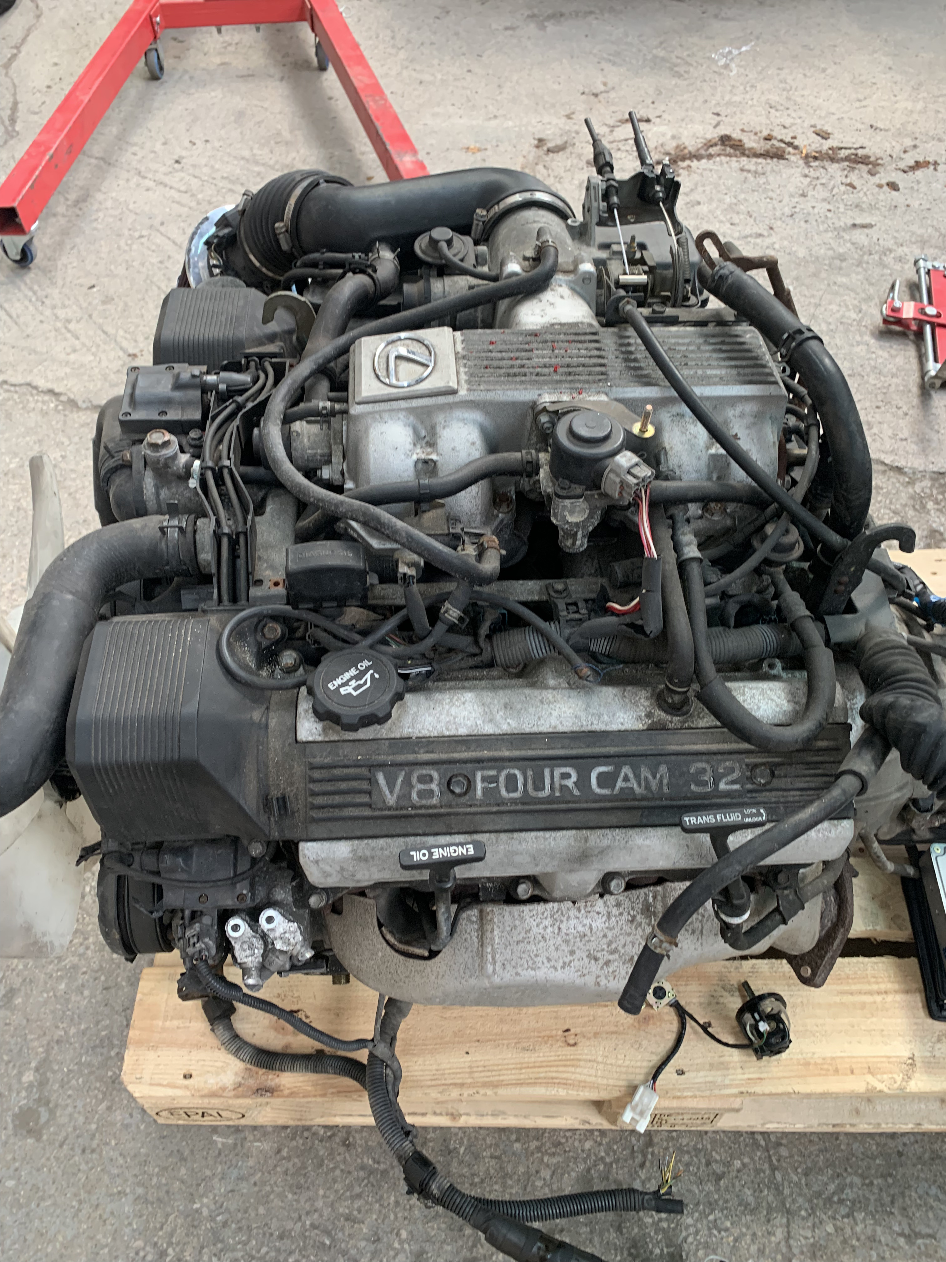

    Last Friday night/Saturday morning I bought a 1UZ, alcohol may well have been involved lol. Not having anything to put it in I have been looking for ideas, Hilux pickup or Surf. I have found a 1998 Gen3, 2.7 petrol auto that seems to fit the bill.
    I have been looking at the gearbox, it seems this petrol Surf has an A343F box which I believe is the same box as the Lexus 30-42LE but with the transfer box on the end? Is this correct and if so can I simply bolt the Lexus bell housing to the Surf gearbox?
    Any other help or advice anyone can give would be appreciated, I'm sure I'm going to have plenty questions that need answeringClick image for larger version
