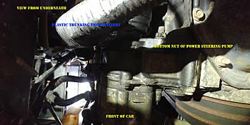

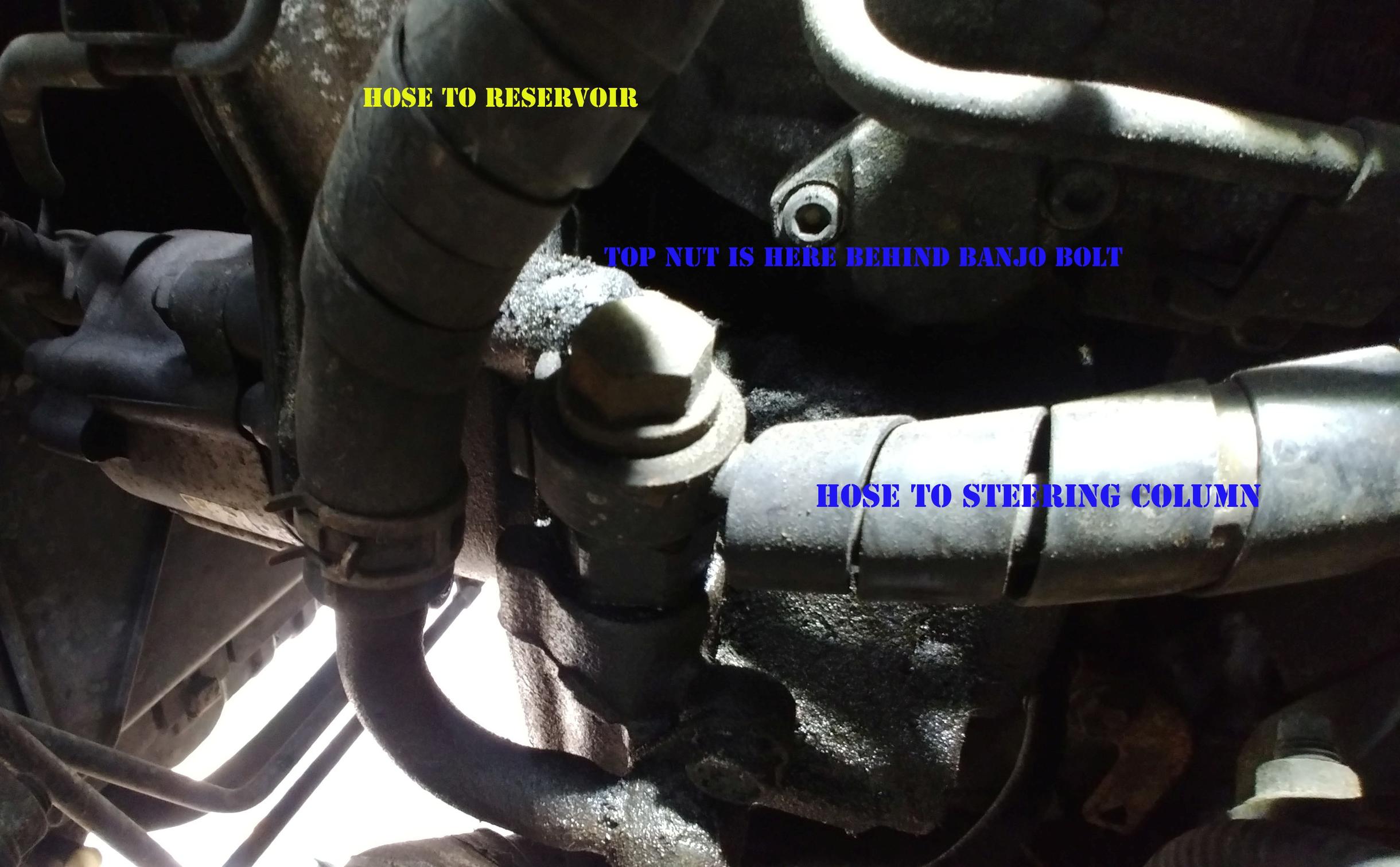

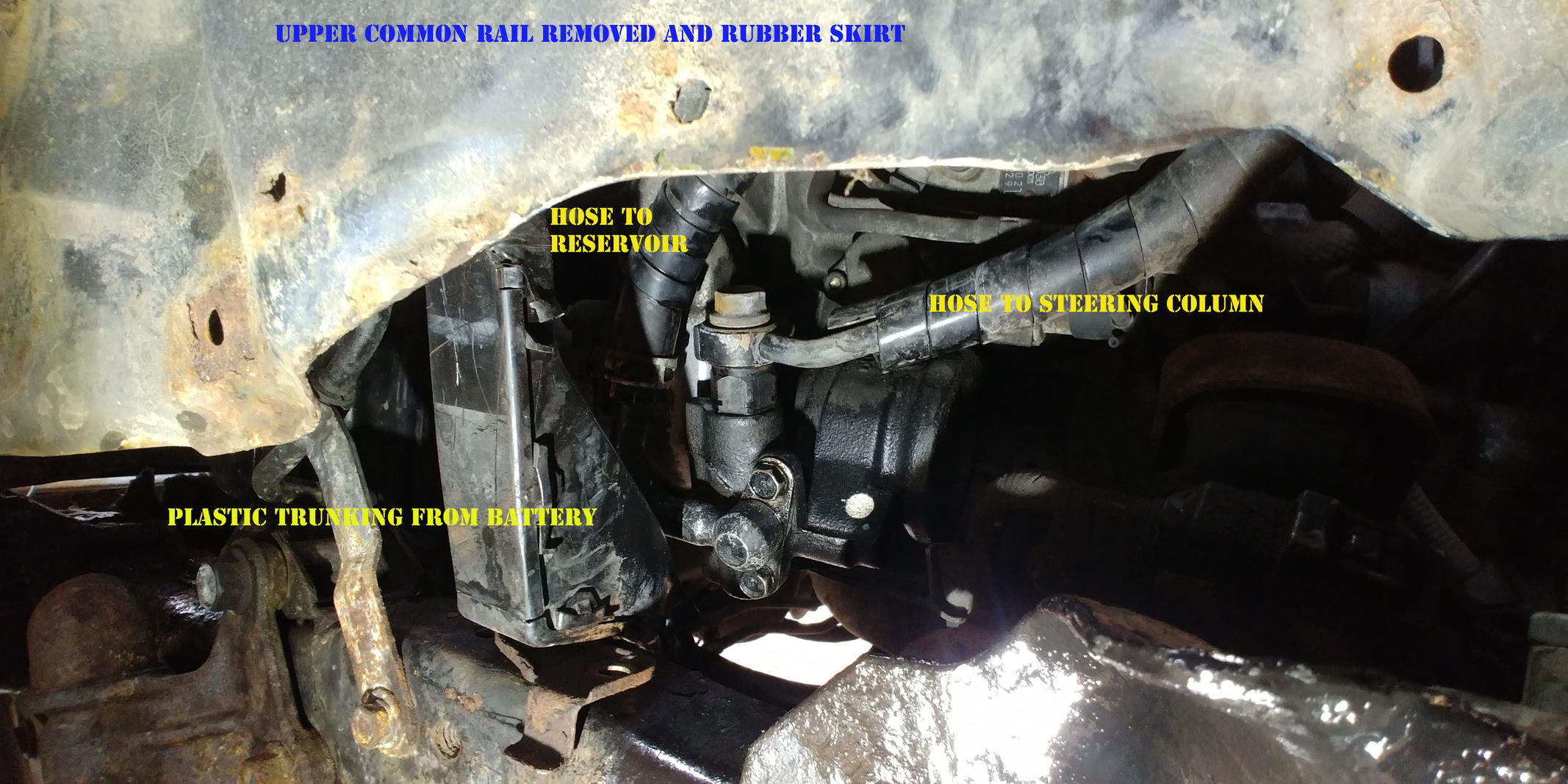

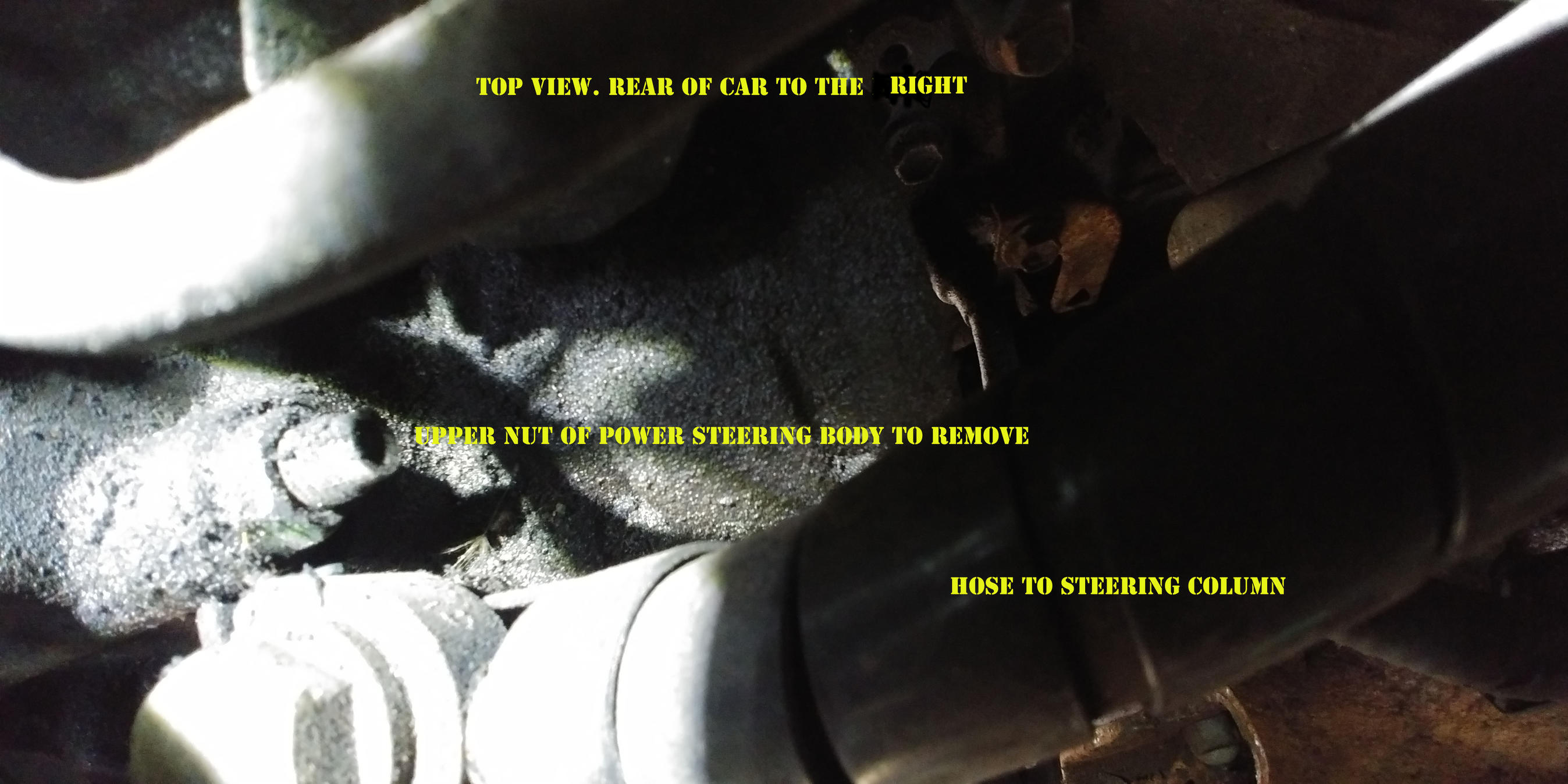

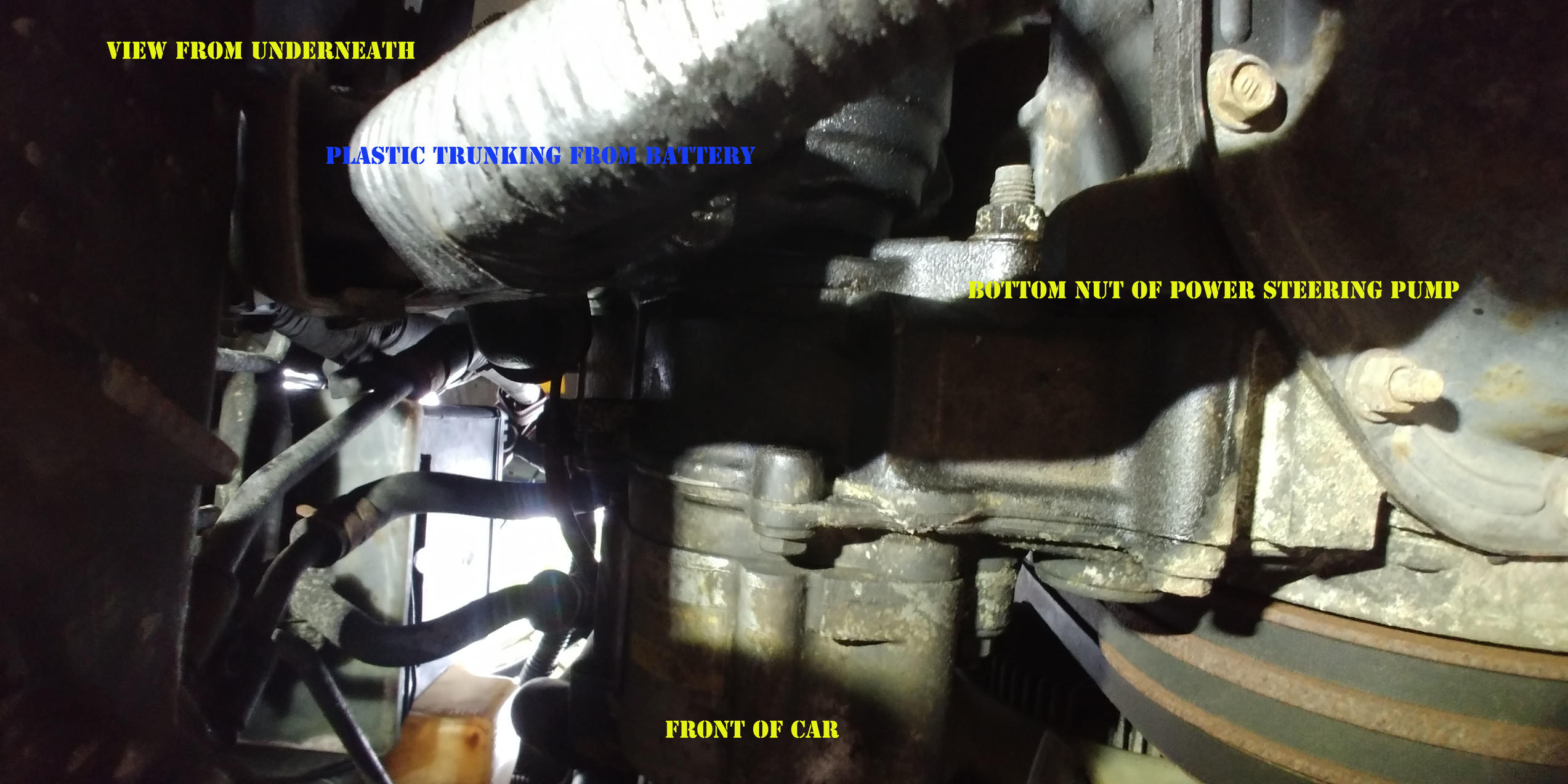

thought I would put some pictures up to compliment the write ups about how to remove the Pump. I am replacing the upper and lower common rails which gave a better view. Please add/amend if I have labelled wrong. My pump is leaking and I am only going to replace the copper washers and oil seal for the banjo bolt and the oil seal behind the plate which is fed from the reservoir.
