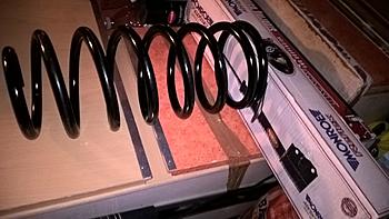

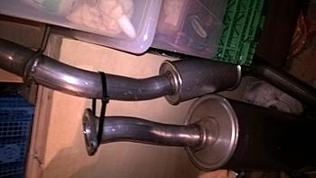

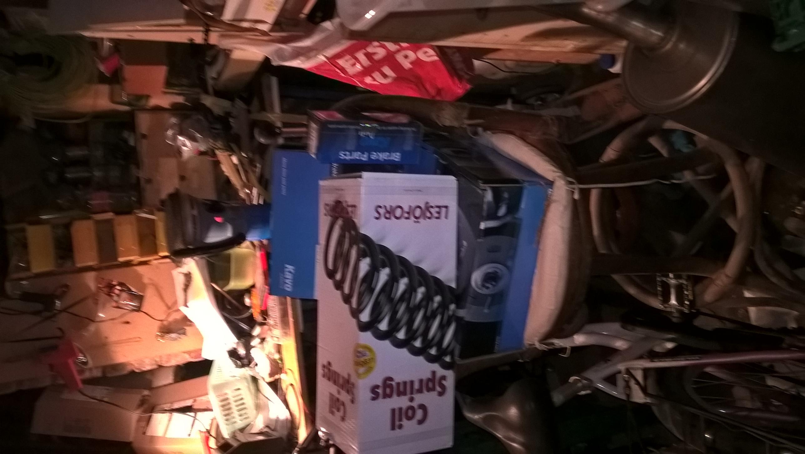

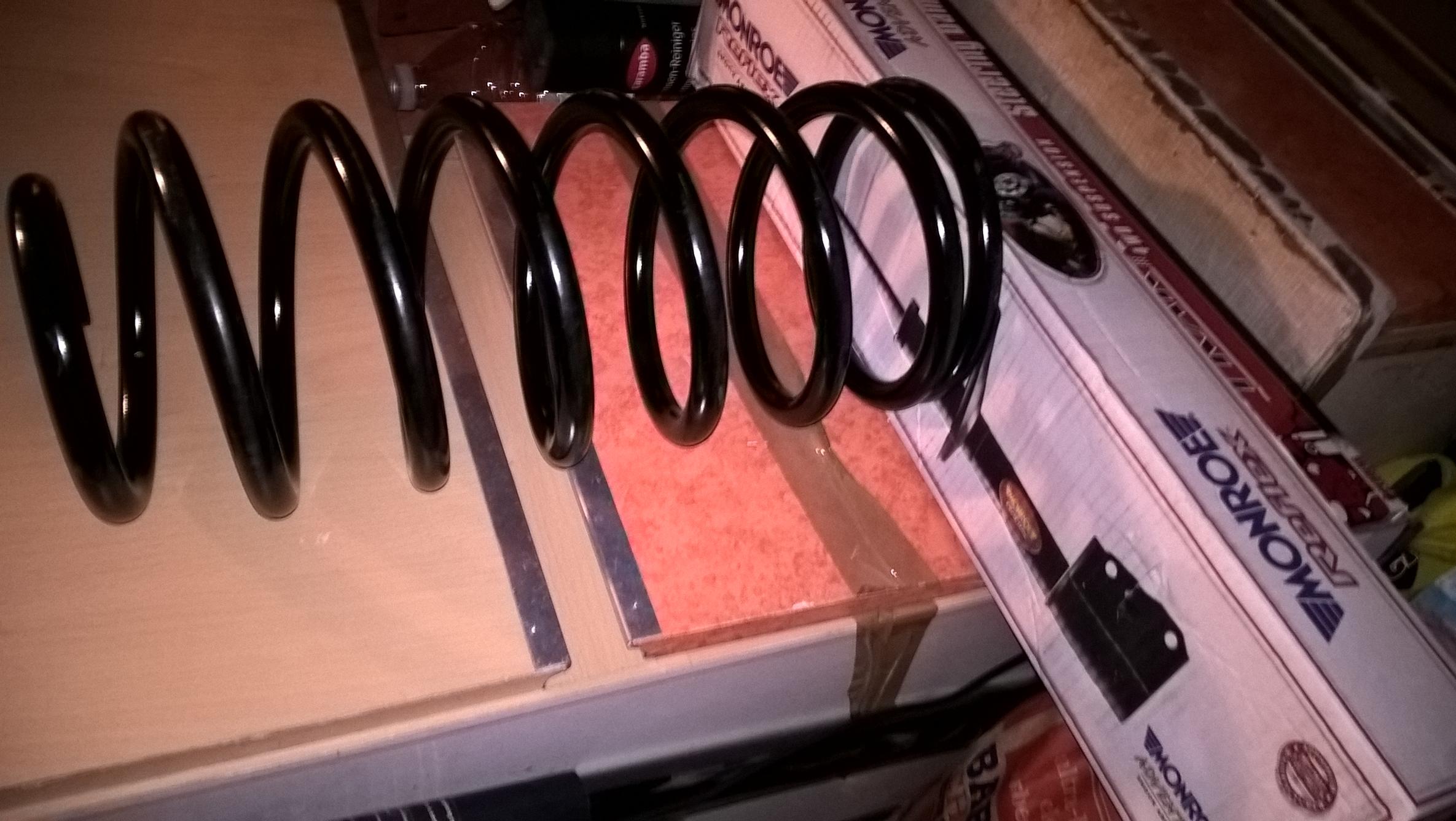

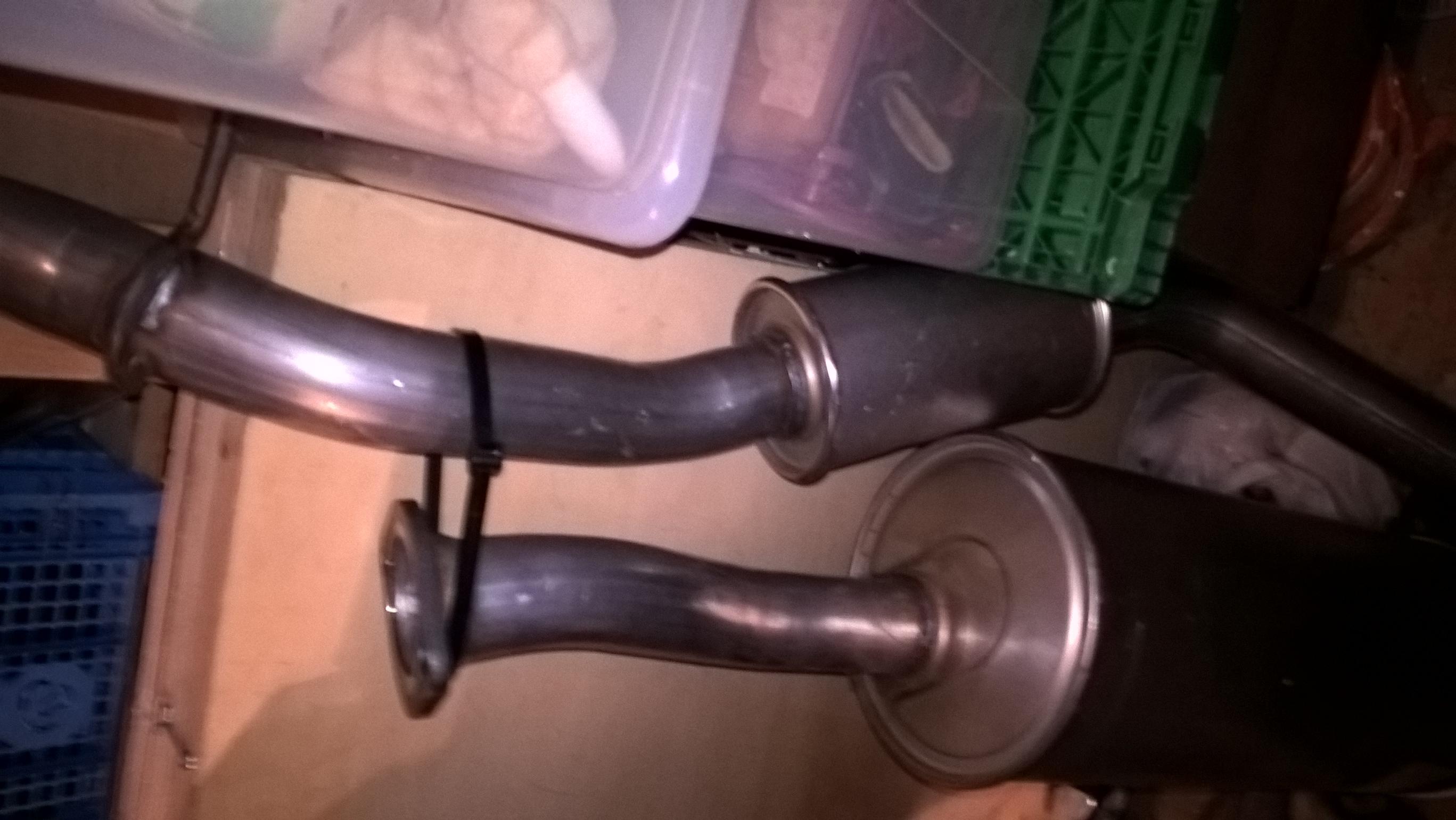

                              I would like to give an update to my work. On Friday, the packages came with 70 KG in parts.
                              The steering is replaced, the steering damper, the rear shock absorbers, the head gasket has changed, the viscose fan is changed, and the water pump. And a few small parts like white side flashers, floor mats and a plate on the trailer coupling as well as the underrun protection are installed. And the exhaust
                              Now missing, the rear springs, all brakes, the shaft seal from the rear axle and an axle sleeve at the front.
                              And then he's done, but I've also been screwed for days on the street.
                              Here times pictures
