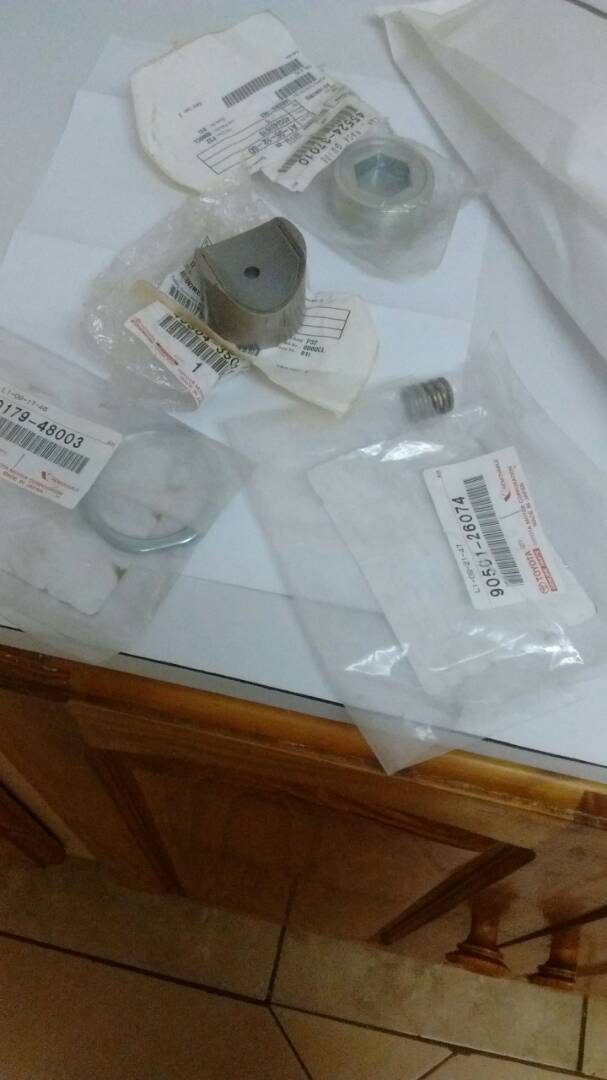

I am going to order the guide kit mentioned in the T4Runner thread:
End sub-assembly, steering rack no. 2/ Guide sub/assembly
45504-35031-
Spring(for steering rack guide)/Spring, compression
90501-26074-
Cap, Steering rack guide spring/ Cap, rack guide spring
45524-37010-
Nut(for steering rack guide spring cap/ nut
90179-48003-
However, while i wait for it (my local Toyota garage will get you anything you want but you mustn't be in a hurry!) I would like to try and tighten the existing guide a bit and see if this reduces the play (without the steering becoming too hard). Has anyone done this?
