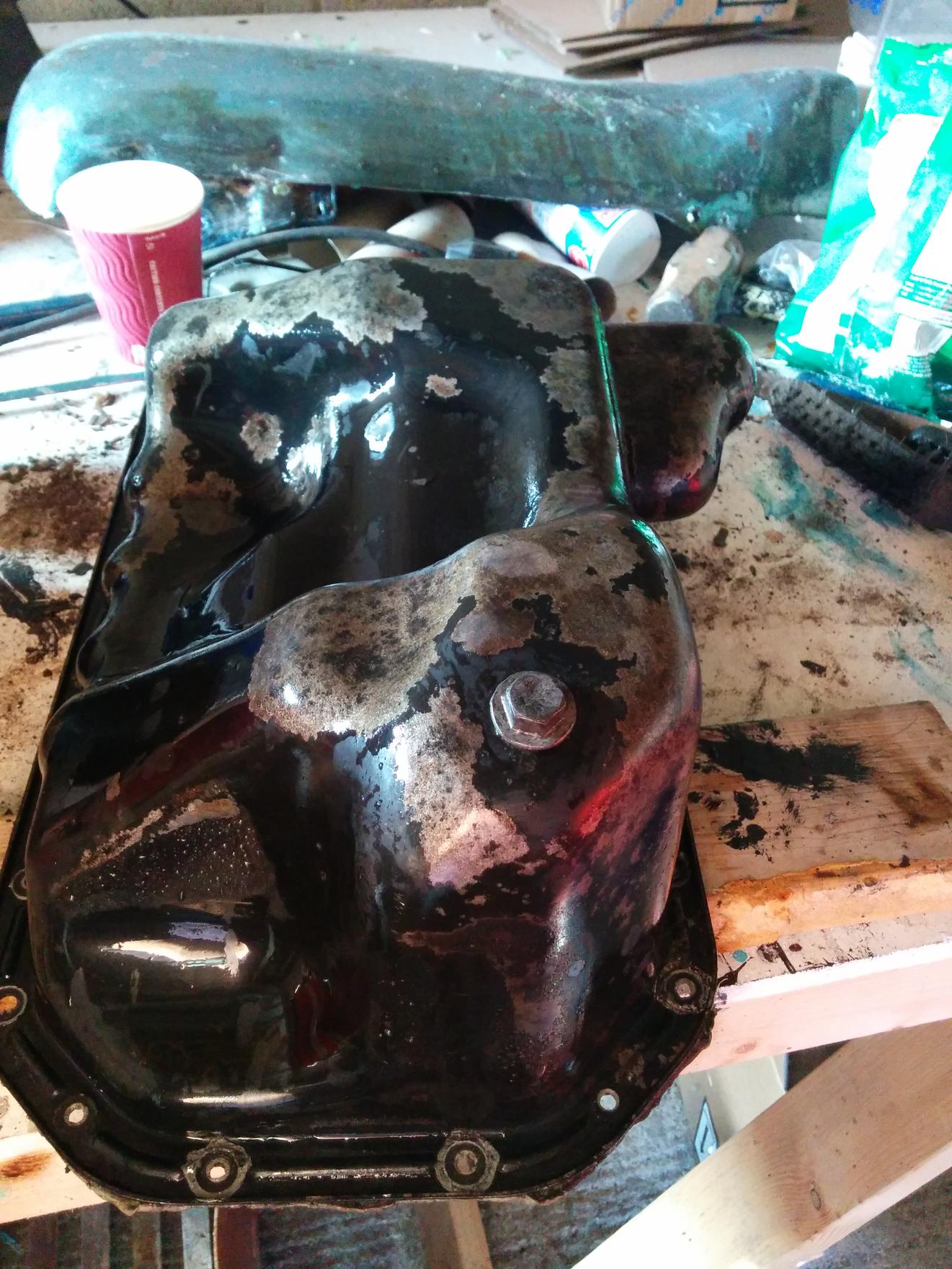

        Nice weather today, so dropped the diff, bit of a faff with my dodgy wrist and I did leave the drive shafts attached...but I can now see the sump at least. Tomorrows job to get it off.

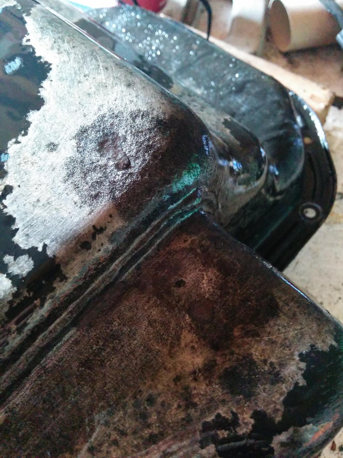

          After some rust removing...found the sump leak...and a few other patches that might be thin enough to weep oil.

                  Its not as hard as it sounds, I was put of to initially...I just did one bit a day till it was off, nice easy targets then for each day.
