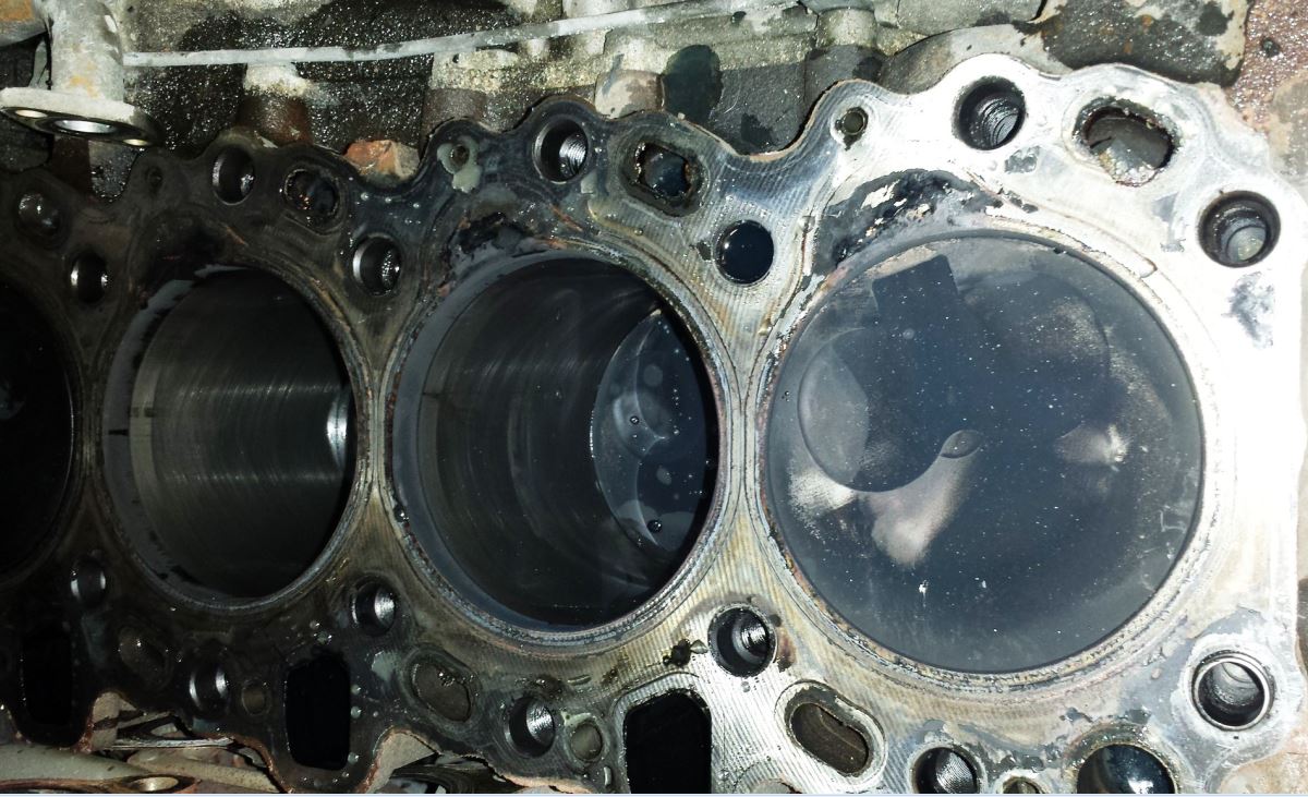

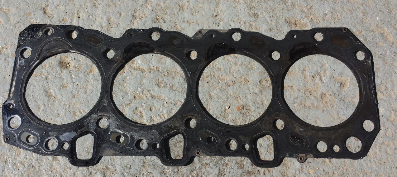

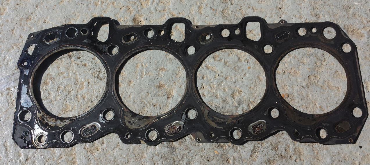

Just pulled the head from a 3.0 1kz as it was smoking grey/white and pumping water out of the expansion tank, the car is a Regius. I bought it like this after previous owner overheated on the motorway and found blown radiator, they had a new radiator imported from Japan (costing £550 apparently) anyway I bought it expecting headgasket/head failure.

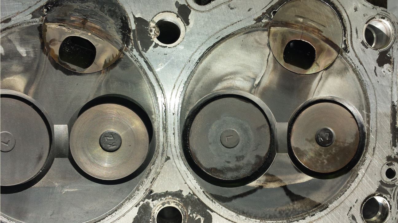

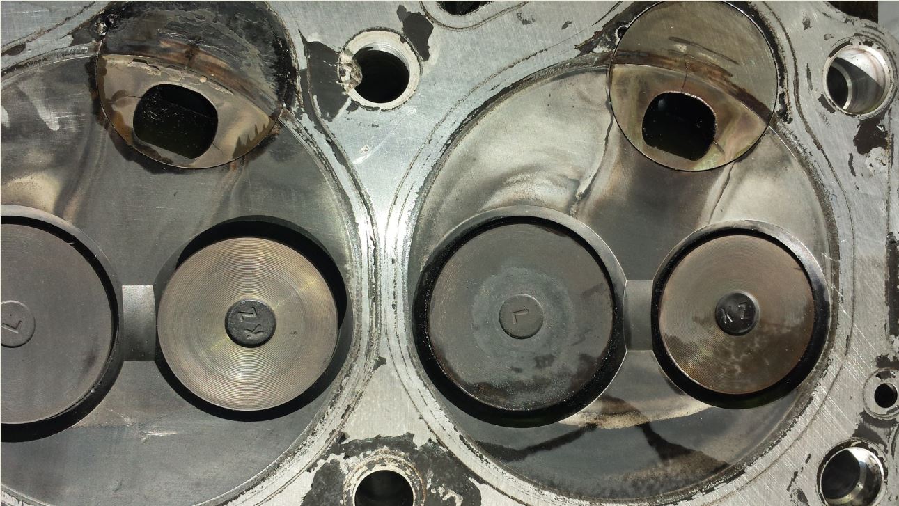

Having removed the head I cannot see any obvious cracks in the head itself but there are cracks in all 4 pre combustion chambers, how can I remove the chambers without the "special tool"? Where can I buy replacement chambers and how much?
Can they be left as they are and just fit a new head gasket to going again?
Of course I will have it pressure tested and skimmed before re-fitting.
