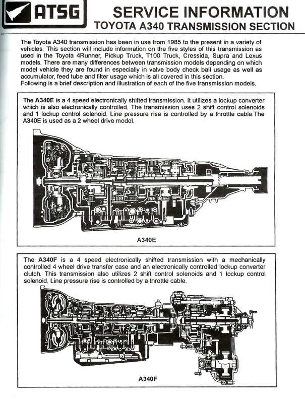

Pic isn't the right box for your car but gives you the gist of how the bits work..I hope...best image I could find at short notice.
