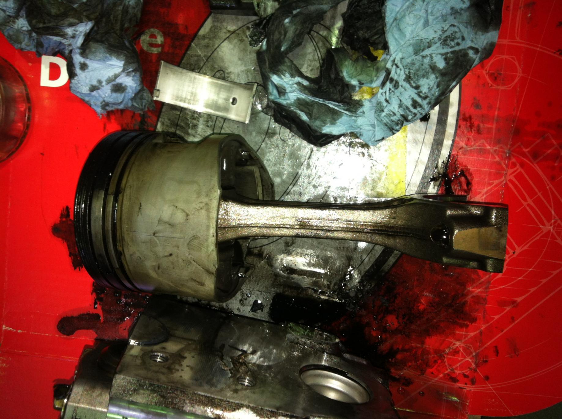

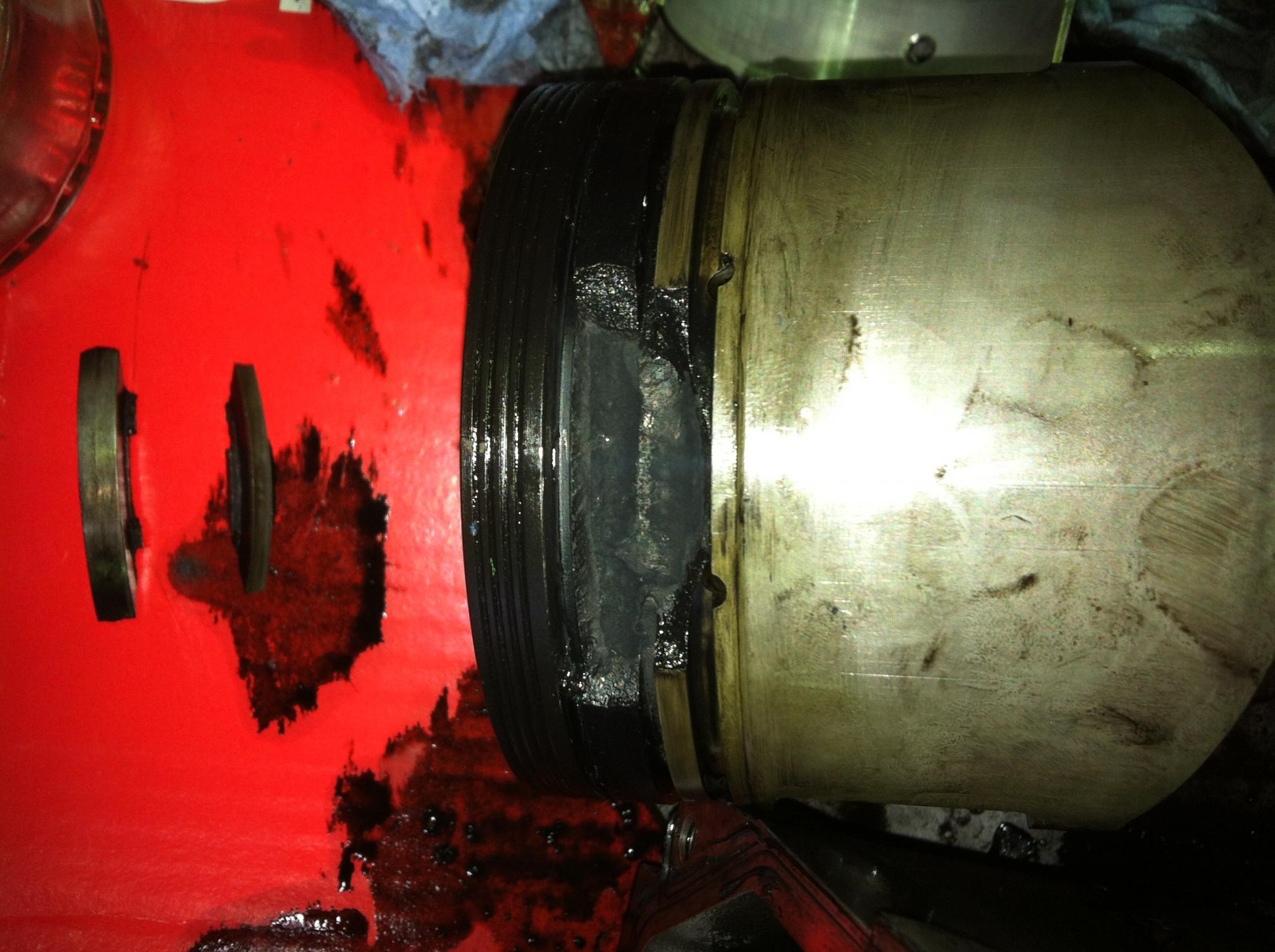

Compression test on each cylinder:
Cylinder 1 = 585
Cylinder 2 = 485
Cylinder 3 = 495
Cylinder 4 = 240!!
Cylinder 4 is the latest issue. Garages think it could be a bent conrod or a porous block? I think the block could be cracked, but if that was the case surly the gases should be going somewhere and coolant system appears ok? Garages have checked all the valves which are ok and are now going to check piston protrusion.
Anyone out there had this level of issues and get to the bottom of the issue?
Anyone every had a cracked block or a cylinder with compression down?
I think I could be looking at a whole new bottom half of the engine at this rate, as all the top half has been replaced
I will see this through as I love my surf but all helpful comments greatly received and any ideas as to what is better? to just replace the whole bottom of the engine or just the block and conrod if that's what it is.
