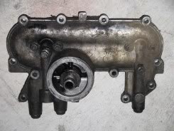

                            Guys,
                            My korean mechanic keeps telling me "oil cooler" (oy koolah)
                            I know that I looks like an oil filter. I've seen it long ago in a car being hoisted. But Is there actually an "oil cooler" somewhere in the 2LTE TD or any SURF engine at all?
                            It's hard to decipher him cuz of our language barrier. 90% of the time, gestures, signals and very very limited english words, that somehow gets compounded due to his foreign tongue.
                            thanks to all for your help.
                              The engine oil cooler is what the oil filter screws into on the 2.4.
