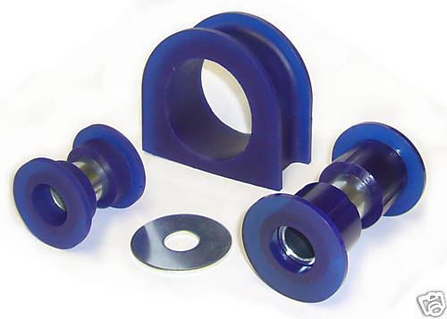

        Hello Tony, just one quick question, the kit is supplied with just one large steel washer (image attached) is the washer to be used in place of an existing or as an additional washer? thanks again for your help.
          It's as well as the one one the truck, that stays where it is, if you look at your old bush its got a metal disk bonded to it on one end, the washer is this part of the new bush (the larger two piece one).
            Fantastic, thanks again Tony.
