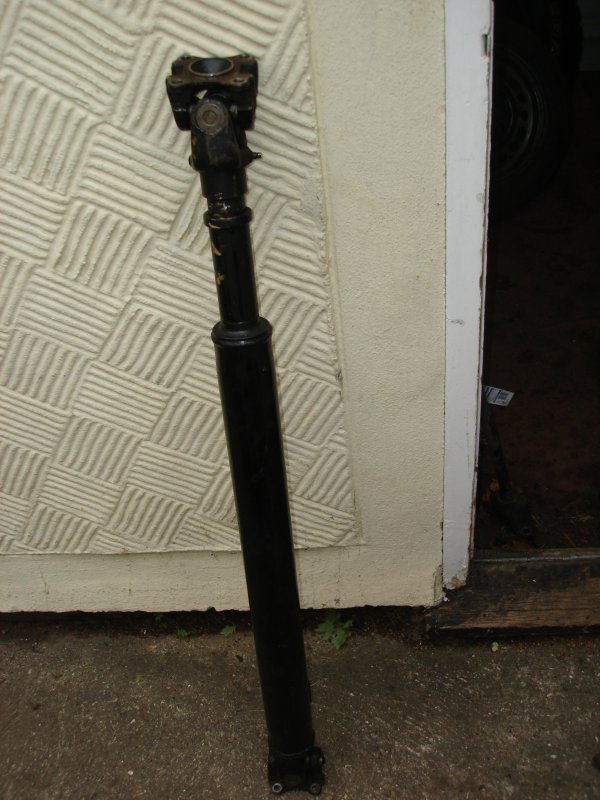

        The ends should match each other - I'll take a pic for you in a mo..

            It shouldn't matter if they're 180 degrees out but they need to match each other. Apparently they speed up and slow down on each revolution so if they are out they can cause vibration (article in total off road a while back)
