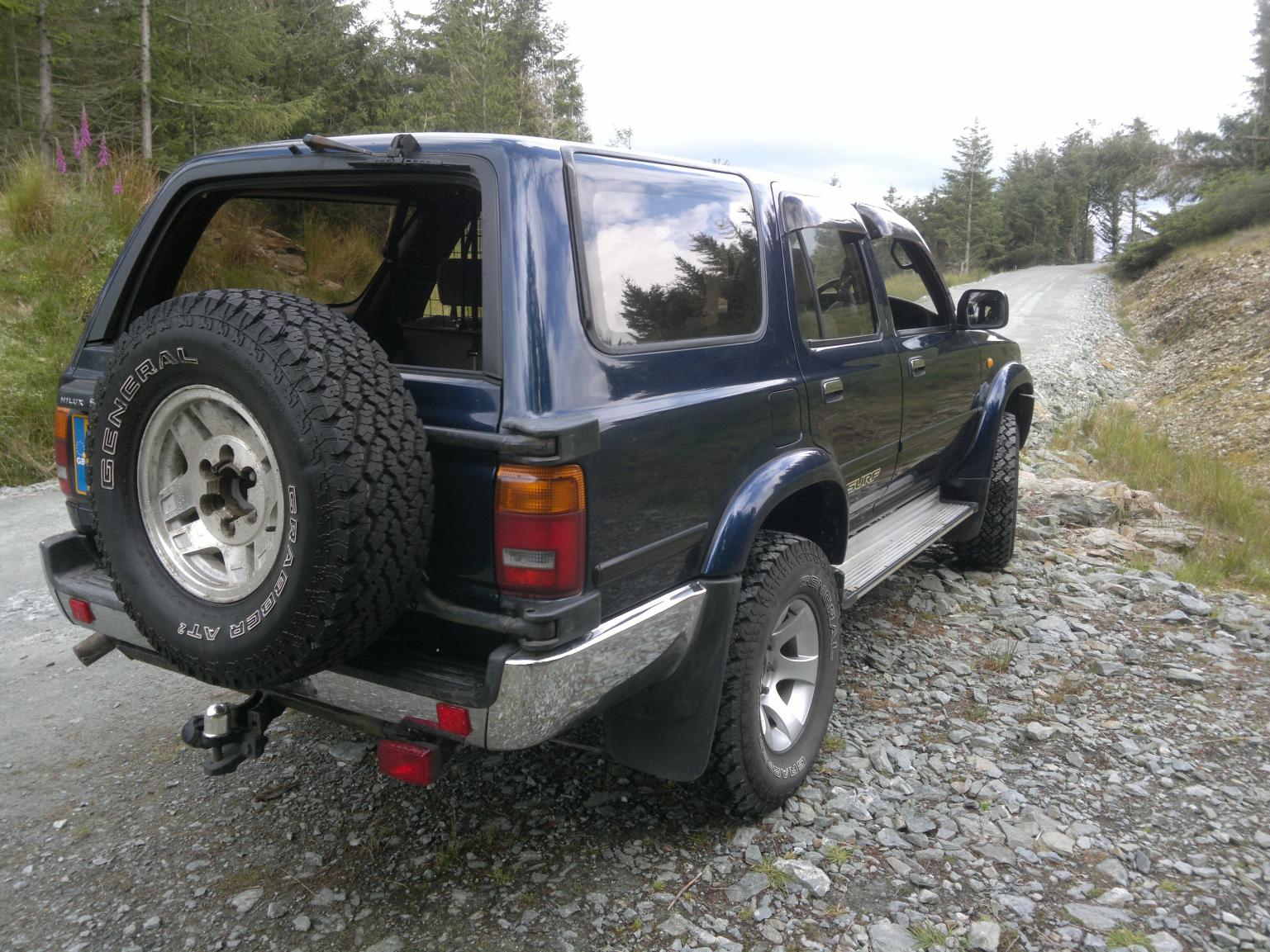

So after I fitted new head, water pump, rad, new coolant and burped the system, I am still getting a slight increase in temperature when climbing a hill say at 60 mph, its only a couple of millimetres increase nothing extreme and returns to half way mark very quickly also, so I am not too worried
but the cooling system should take 10 litres and I am still left with some coolant maybe around a litre or less possible between half a litre and a litre..
in one of the bottles....
I have ran the heaters on hot both front and back heaters several times and the air is HOT without a doubt, I left rad cap off for two days squeezed all the hoses, it wont take anymore coolant?!
also fan is working fine too, truck runs great, idles great and temp sits bang in the middle at idle and normal cruising, just when climbing long hills for a few mins is where its happening,
does this happen to anyone else, I cant remember before the head cracked what sort of variance the needle had, but I am sure it sat bang in the middle rock solid no matter how hard I drove it?? true???
Thanks guys.
