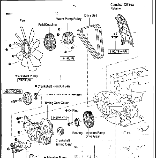

                Its a toyota belt, and I had spare(non toyota) and comparing them they look the same, But I have just tried screwing the bolts in without the tensioner and they are still hard, the thread on the back plate is knackered!!! the garage that did the belt the last time has caused some damage here!
                what is this back plate below the oil retainer plate called? and where can I get one, I am also just going to get a new idler pulley and tensioner, taking no chances here....
                  If you mean the part the bolts screw into, not sure its official name, but if you want one I have a used one if you want to save a cash on a new one! I'd probably try helicoiling the screw holes first though, would save taking lots of stuff off.
                    Hydrolocking ? Clean out any oil in the hole and try again.
                      Thanks Tony, I have been searching to try get one, I think its the timing gear cover?....I have never tried Helicoiling but sounds like a plan, nothing to lose, what would I be looking for to do this? and if this fails I will likley come back to you for that cover.
                      Aint that Wishbone its clean, the bolts came back out with strips of metal in the thread!
                        yeah, exactly that. lol
