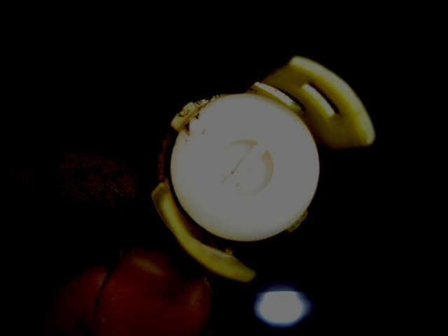

. Undid them and took the switch off. Removed the black plastic shroud off the switch which then showed the yellow wiring connector attached to the bottom of the switch. I unclipped this and inside was a white disc with a raised slot in it (Pic A) and a raised white nipple on the edge of this disc. DO NOT TURN THIS WHITE DISC UNTIL YOU HAVE DISSCONNECTED THE WINDOW POWER MOTOR!!! JUST UNCLIP ITS POWER CABLE CONNECTOR. Dont do what I did.... I turned it just to see how it worked and the window started to go down into the tailgate. It dragged the B####Y connector back under the window as it went to the down position AND NEARLY TOOK MY FINGERS WITH IT. I then had to reverse the polarity on the window motor to raise the window again as for some reason it would not operate from the switch inside the cab.

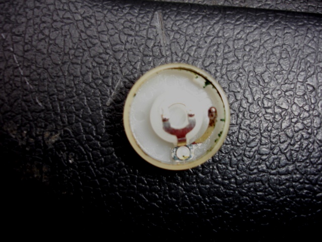

On the back of the white disc is a contact (pic B @ 3 0'clock position) which connects on the corroded contacts when turned left or right by the key. Once inside I could see the problem. The contact terminals in the base were corroded on the ends as the large photo shows at the 7 and 9 o'clock position. A bit fiddley but my mate soldered small extentions on the ends of the corroded terminals making sure the original distance between the two terminals was the same. This gap is important as it allows leeway for the key in the switch to return to the neutral position without the pick up terminal contacting the up or down position in the switch. I reassembled the unit and hey presto! it works fine. Obviously this is only a temporary solution but I think we can sometimes overlook the key switch assembly thinking it could be a more expensive problem.
A. White Disc with screw driver/key location slot.
B. White disc once unclipped and turned over showing "Pick Up Terminal"
After the white disc/terminal contact had been unclipped and removed this is what I found. Ends of contacts worn.
 Now back to where I was.... I removed the white disc marking its position relative to the yellow housing before unclipping it.On the back of the white disc is a contact (pic B @ 3 0'clock position) which connects on the corroded contacts when turned left or right by the key. Once inside I could see the problem. The contact terminals in the base were corroded on the ends as the large photo shows at the 7 and 9 o'clock position. A bit fiddley but my mate soldered small extentions on the ends of the corroded terminals making sure the original distance between the two terminals was the same. This gap is important as it allows leeway for the key in the switch to return to the neutral position without the pick up terminal contacting the up or down position in the switch. I reassembled the unit and hey presto! it works fine. Obviously this is only a temporary solution but I think we can sometimes overlook the key switch assembly thinking it could be a more expensive problem.
