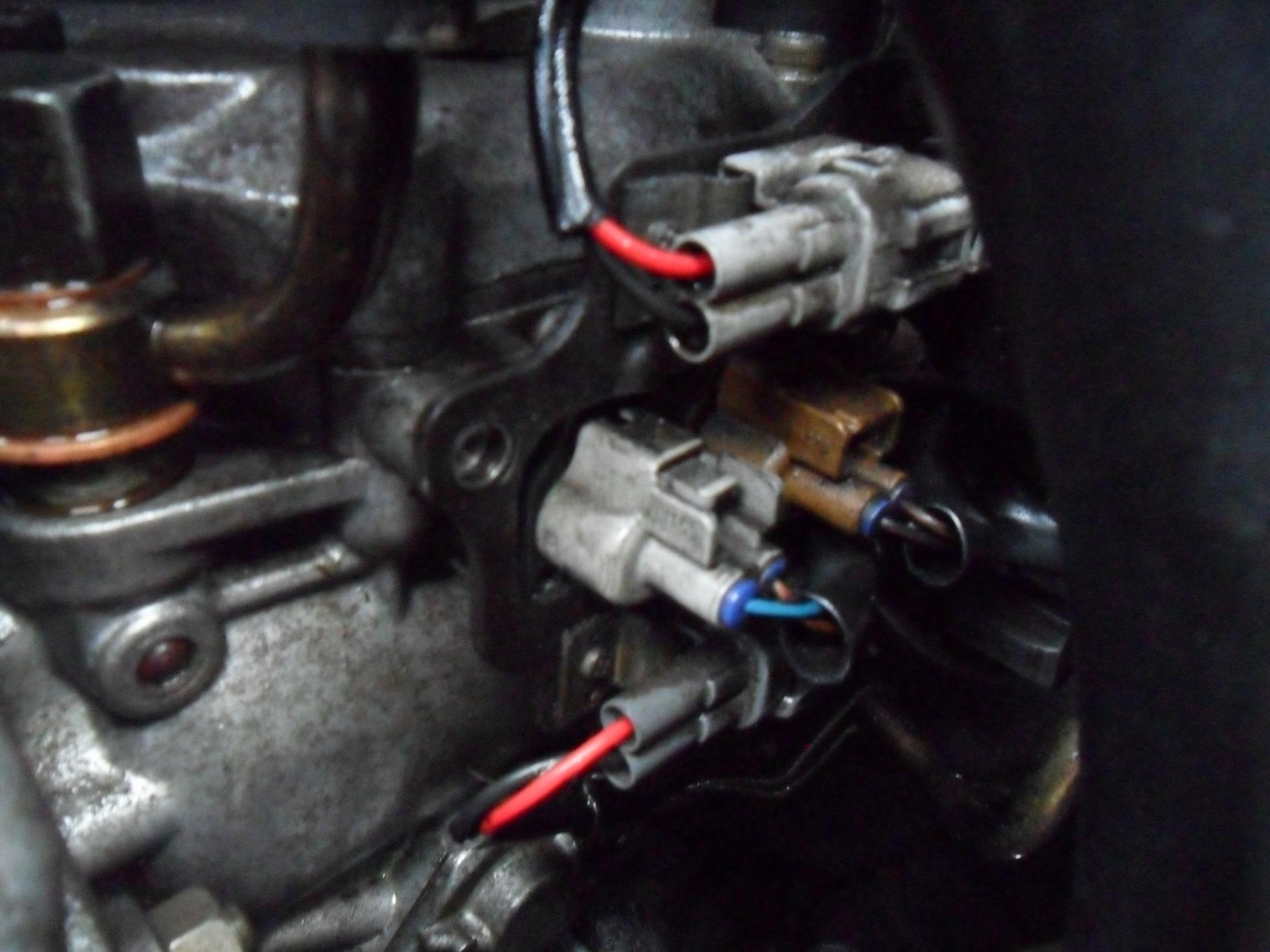

                              Heres the same one as mine....
                              Is it the one connected to the grey plug in the middle? If so, does the cap flip off and how does it come out?
