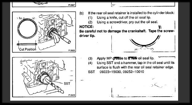

    Crankshaft oil seal - about £11 for decent Toyota one. Don't fit a cheap one - I did and ended up having to do it again after 3000 miles.
    Rob.
    Biggest problem you'll hit is holding the pulley when you put the crankshaft nut back on (need a big torque wrench to torque back up)
            Rob.
            Rob, thats a pic of the rear crank seal....
                haha so it is.. I'll try and find the right pic give me a min.

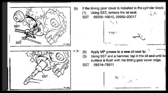

                Here we go :
