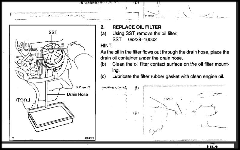

        pic...
        edited as misread the post...
          Thanks for the pic Wishbone.
          I had assumed it was a breather rather than a drain and the continuing drips of oil may indicate the oil filter is not sealing or seated properly, I suppose. It looks like a simple 'spin-off' filter, with no means of attaching a spanner, like in the diagram you posted. Should be easier to see when I get the filter off, and as I've managed to snap the drain off just above the injector pump, I'll need to replace it.
