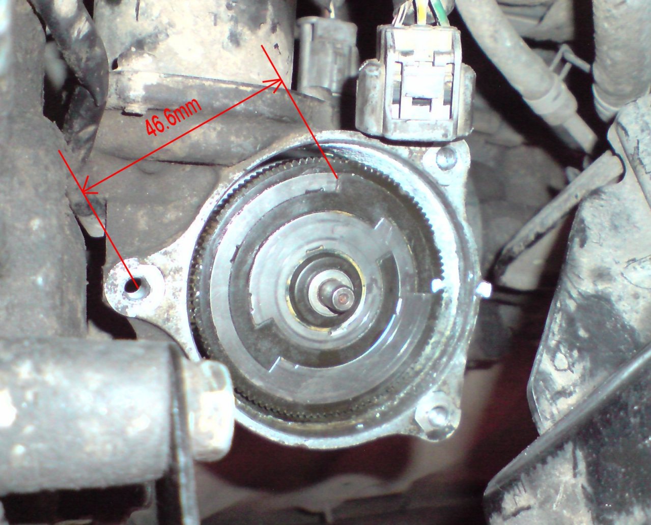

Problem:The rotating gear came out and I did not mark it's position/orientation. Replacing it anywhere results in all sorts of strange clunks and lack of drive and more flashing 4WD lights.
Solution: get the truck in 2WD, so the front prop shaft is free to turn. If you put the wheel back in wrong then this will take some experimenting to get it back into 2WD. Then set the wheel in the position shown in the attached photo.
Hopefully the lights will stop flashing and you will be OK to engage 4WD.
