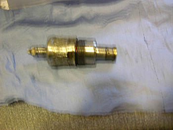

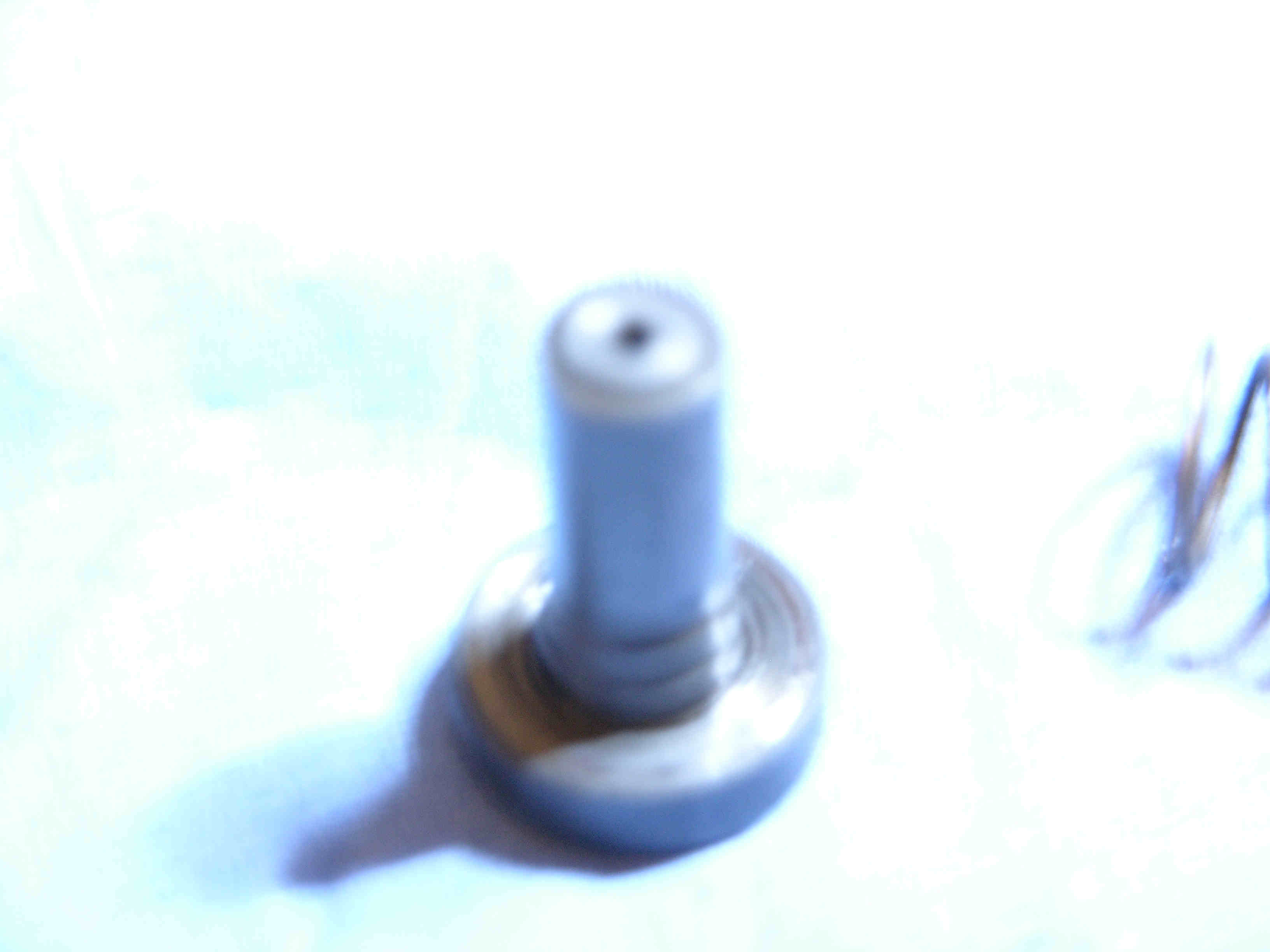

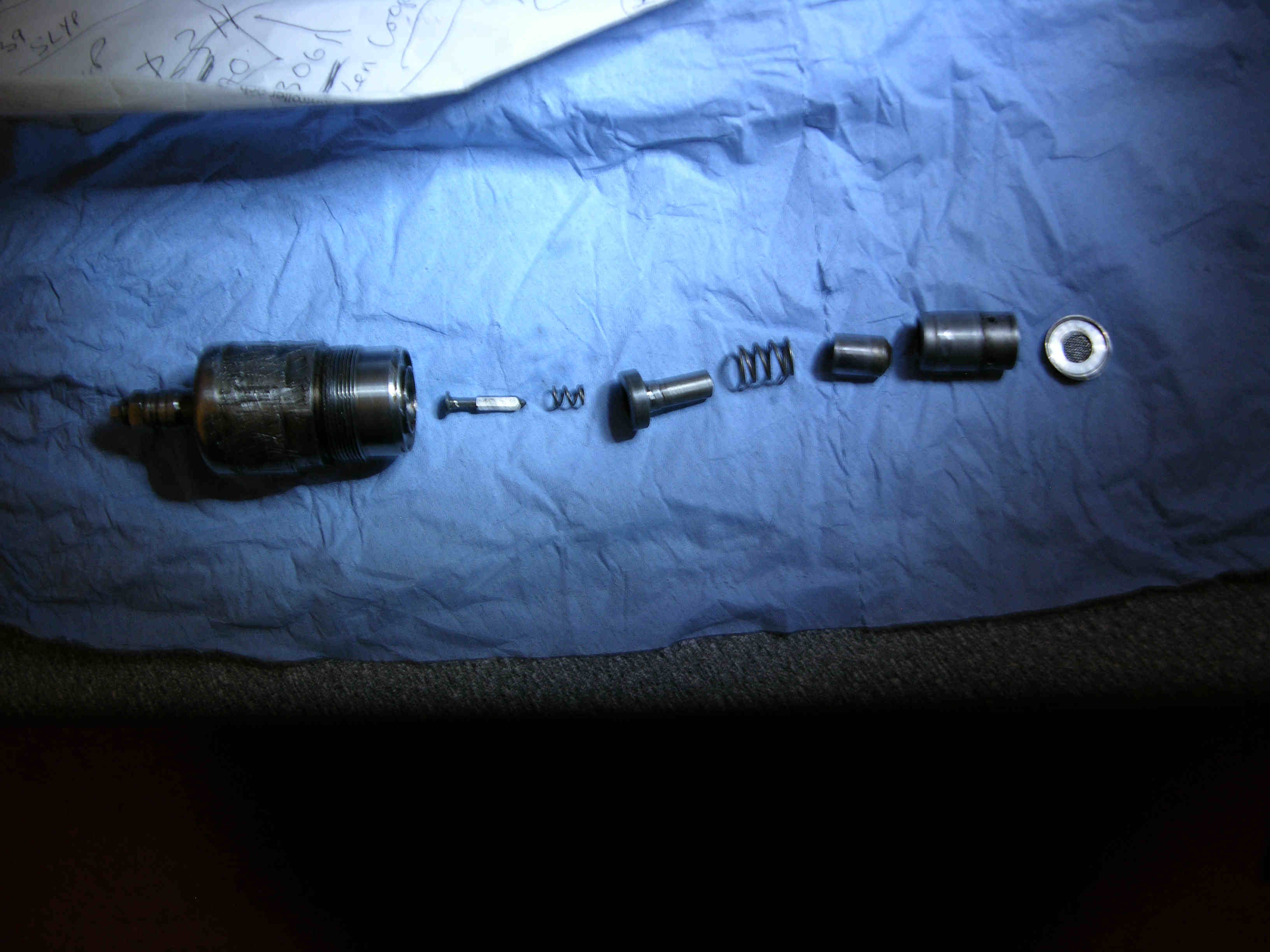

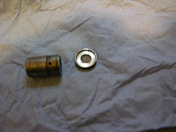

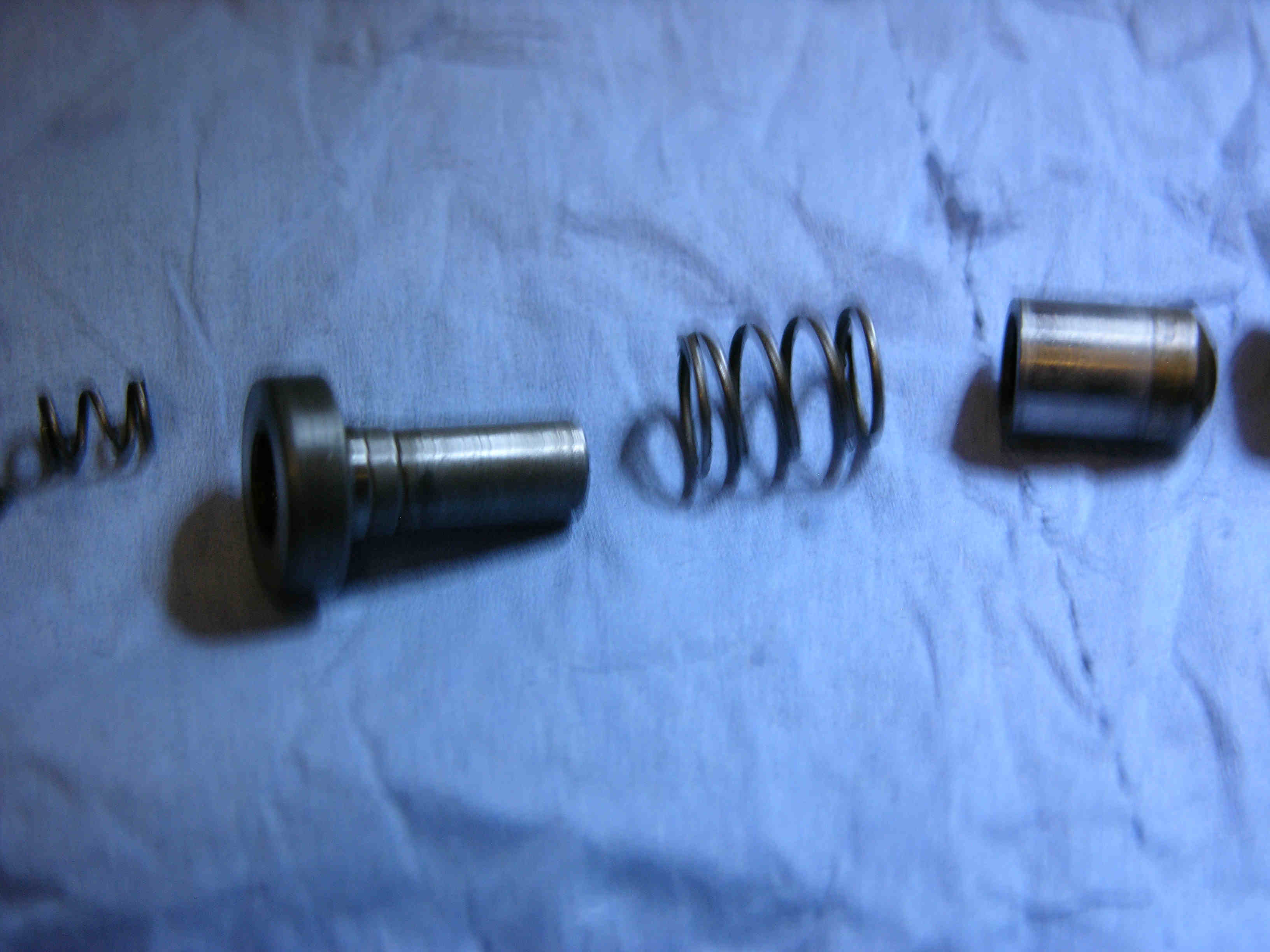

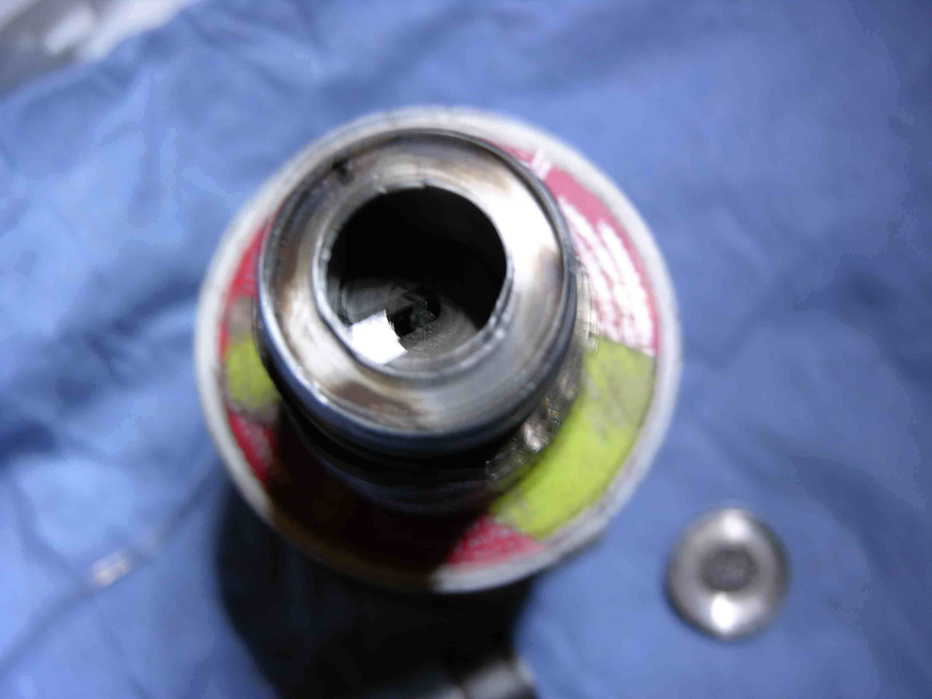

Hi Guy's.
Since there were so many views on the old thread I thought it would be better to start again.
The old thread is at http://www.hiluxsurf.co.uk/forums/sh...ad.php?t=54819
Its been six months or so and the 3ltr turbo beast has been working well until friday.
I did an 80 mile round trip with frequent stops all without any problems.
Did a bit of local running and stopped the beast to let my grandaughter into her house (less than a min) went to start the beast, it fired and died straight away.
Nothing from the injector pipes, called the AA and got a recovery home.

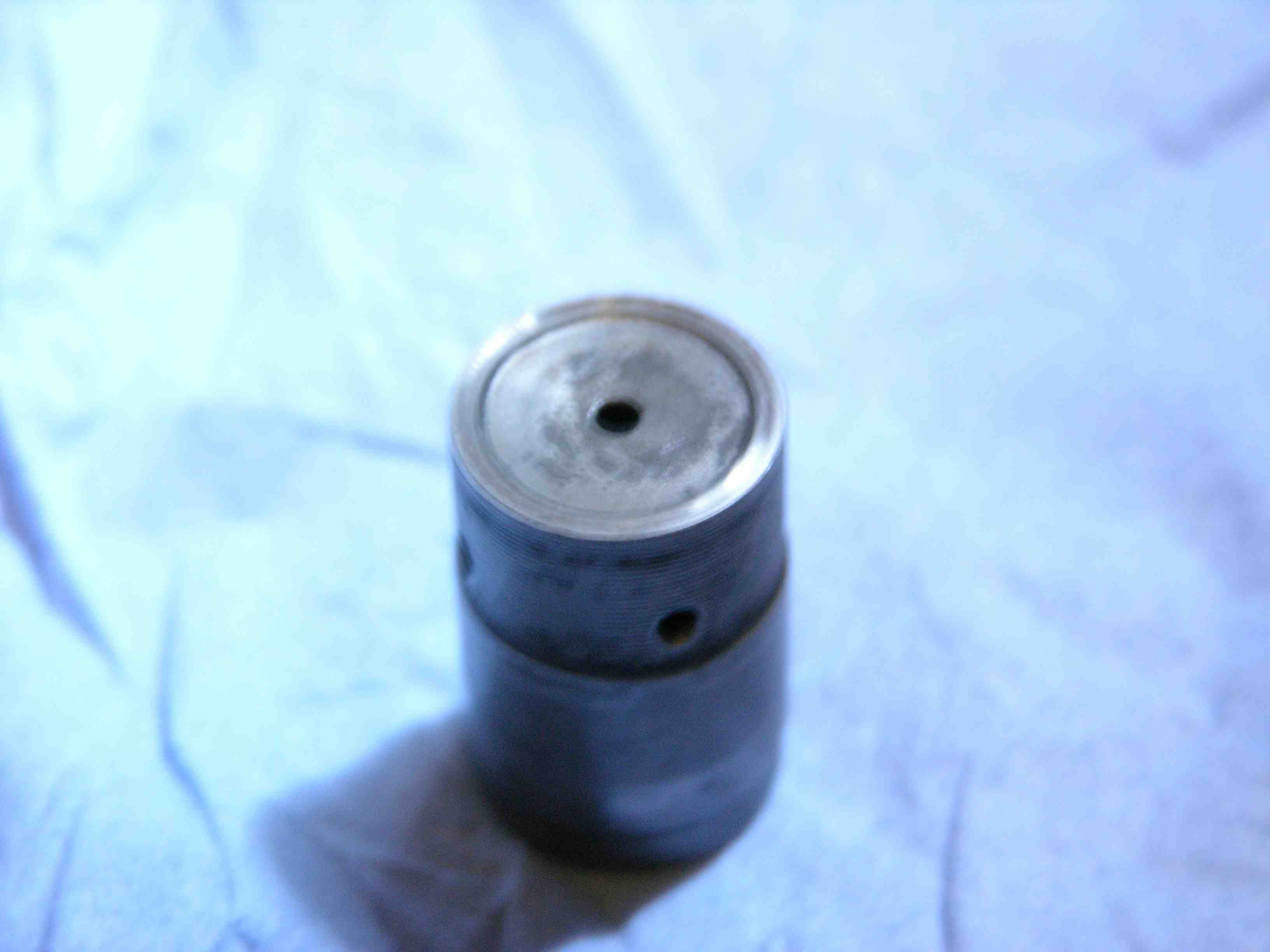

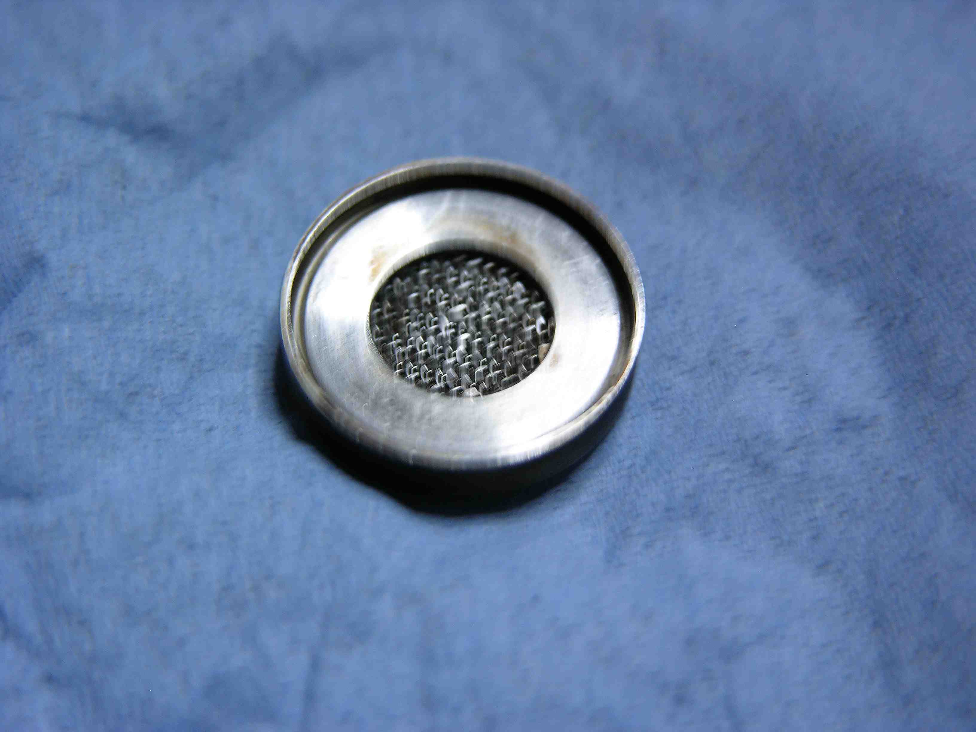

Well I removed the little thimble filter from behind the fuel temp sensor (it was coated like a piece of carpet) and replaced it with a clean one.... still nothing.

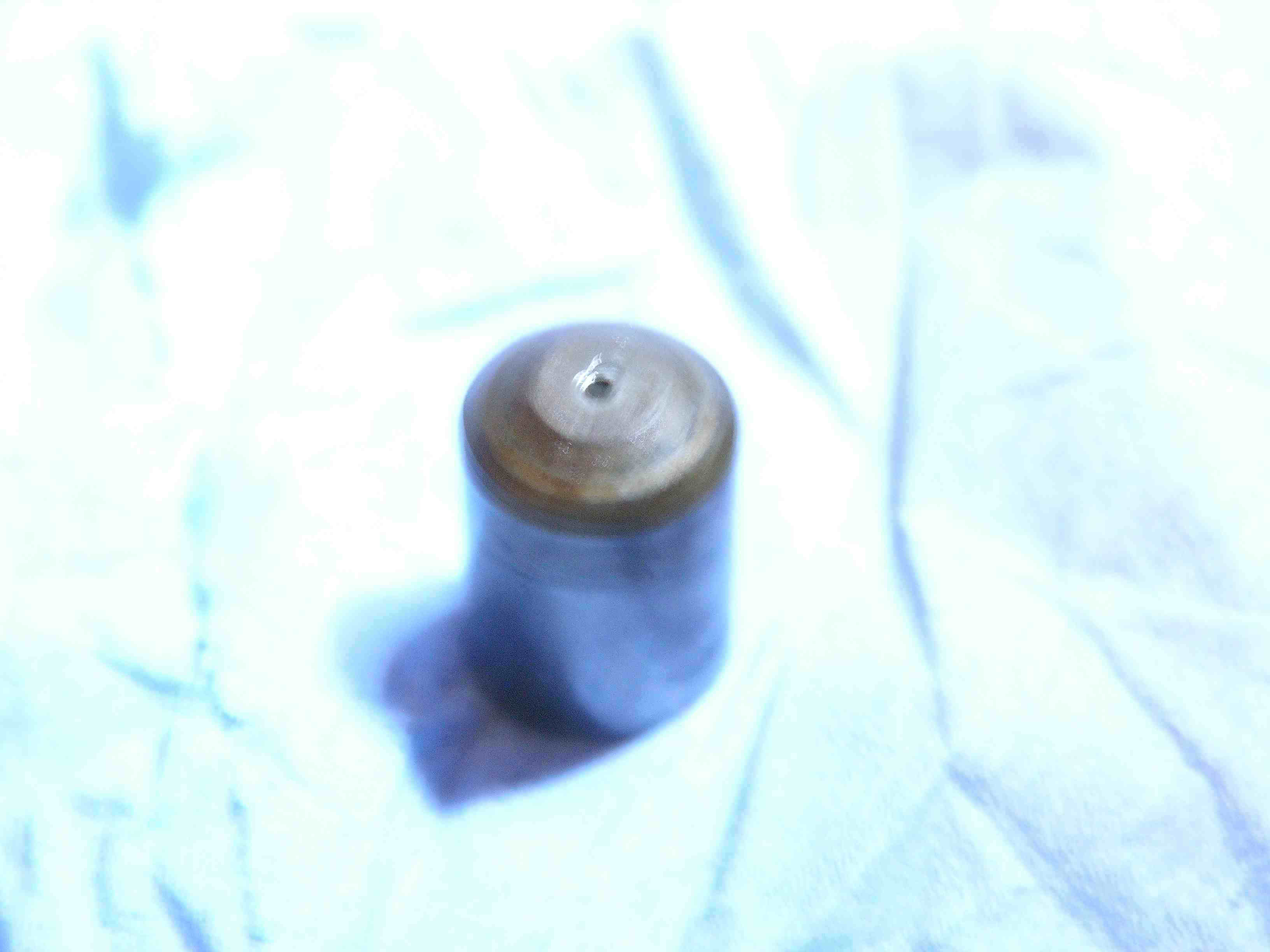

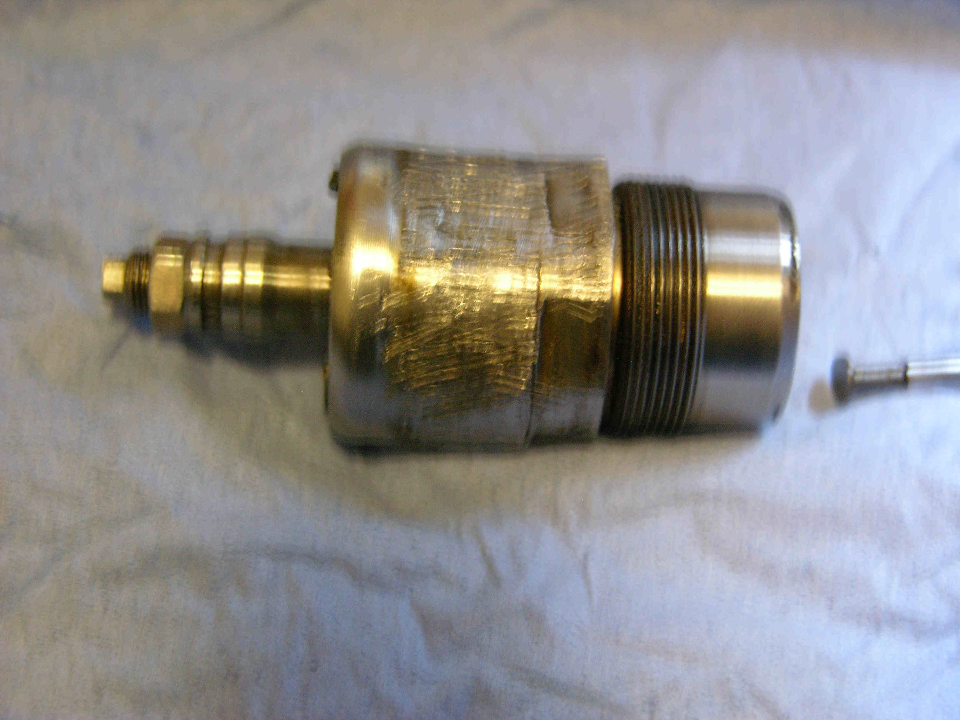

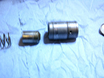

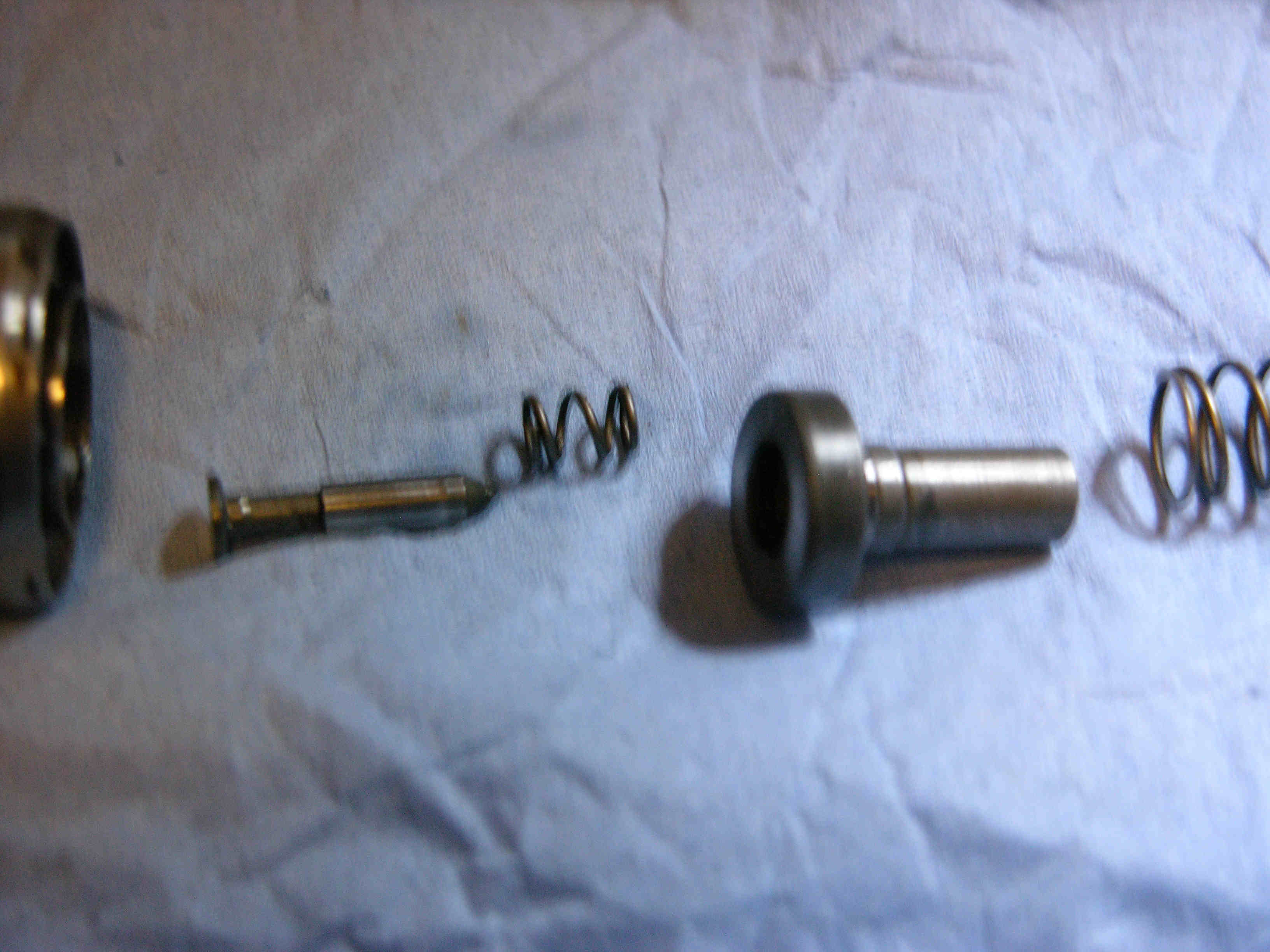

Removed the pump and opened it up and flushed out with white spirit, a lot of crap came out but could not see any problem, refitted today (in the snow) still nothing, not a dribble out the injector. Flashed the spill valve solenoid and it sounds like it is operating.
I am a little concerned that this is the second pump to show this problem, I stripped my old one down when I got this replacment one from Stormforce but did not find anything.
Does anyone know the common causes of failures for this pump or have any links to diagrams of the internals please.???
Unless I can find out how to fix this pump I shall be looking for yet another one I guess..... Anyone seen any about????
Regards John
