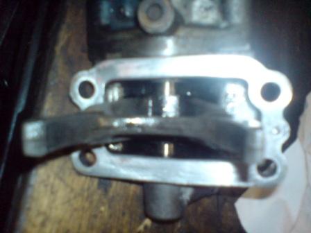

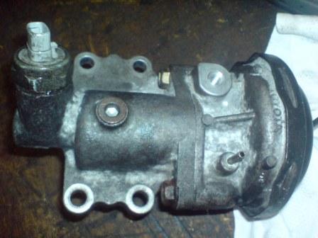

Has anyone stripped one of there or have any pictures of the transfer box shift motor?
I think it would be a good idea to put our collective knowlage of this problem together.
For my part i attach pictures of the front diff shift forks. I took mine off and checked it but all looked fine.
