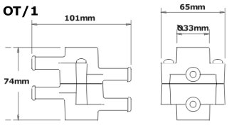

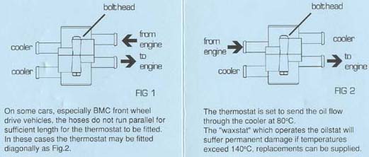

                      Can I ask for more details about the mocal setup ? I have an extra trans cooler to fit before my trip to spain so could maybe incorperate this into the install..
                      Thanks,
                      Rob
                        Hopefully these attached diagrams will help. The waxstat I used has push on connections, to be used with hose clips. I bought mine from Demon Tweeks, but they are widely available.
                            Thanks for the info They look pretty easy to put in with the cooler. I think I'll be getting one soon.
