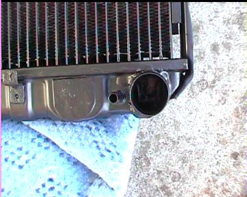

      Sounds like you could do the opersite of what I did, if you got a good top tank (the known weak spot) and you are going to have a new core anyway, why not have a new bottom tank made upand re core the rest....at least you know what you got then!
      I personally dont like alli rads, I believe with all the different metals in the system alli being the softest it can become the sacrificial metal if electrolosis were to occur, a non zink brass would be far superior
      Trouble is iv'e lost faith in this rad, It had a new 4 row core about 4years ago and since then its been out to be resoldered every year to date and sometimes more than once a year! BTW I also moved the coolant outlet spigot to the other side of the transoil spigot so it didn't impede the oil cooler.
      It made absolutely no difference at all !
      As Matt said the thermostat has a smaller opening than the restriction by the coolant outlet.
