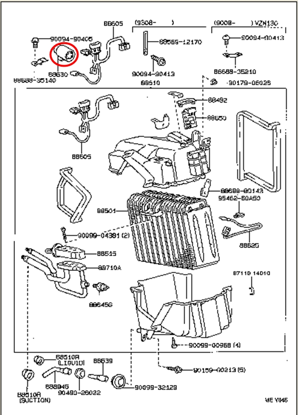

                      There is a relay on Evaporator Housing but I have no idea if this is for the compressor or how to check it.
                      Nev
                        You can see the relay top left of first and second pic and top right of third pic here -
                        http://www.toyotasurf.asn.au/techsit...npictorial.htm
