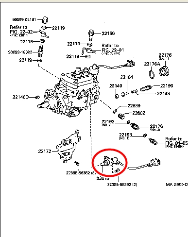

          Is it anything like this;
          http://www.chinahanji.com/VE%20pump.asp
          http://www.toyotasurf.asn.au/techsite/fuelpump.htm
          http://www.vepump.cn/ProductType.asp...e=CZ-D.DENSO(2)
          The 3rd one takes a little while to load.
          Check the pics and see if you can see the part that leaks.

            Cant see the offending item on the first two pics third pic wont come up

              Timer Control Valve if it's the bit in the diagram.

                Hi thanks for getting back
                Little late replying been away
                Thats the part

                    very expensive @ £186 for such a little part
                    Just changed it (what a job to get at) the old one had a crack in the back
