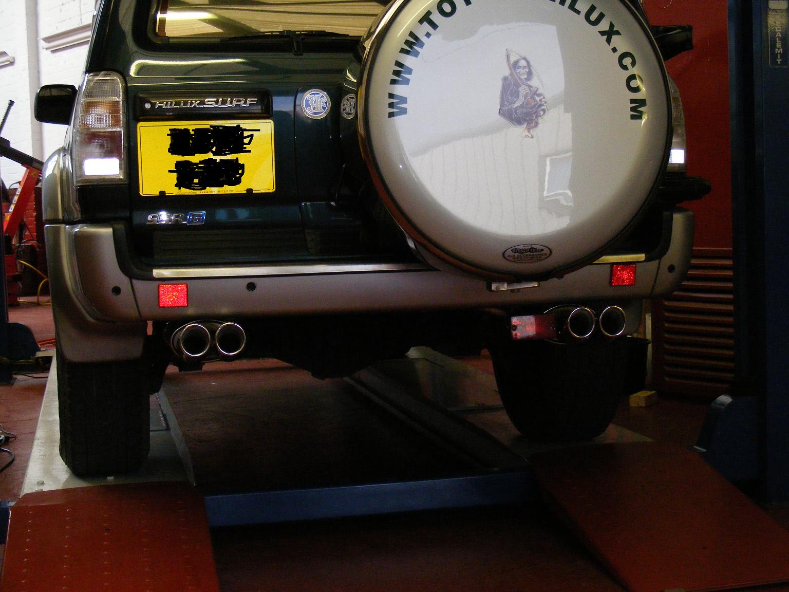

    Also, next Friday (21st) it's off to have a powerflow twin exit exhaust system fitted. From the single downpipe back, it will have the massive silencer removed and replaced with a flowthrough silencer, then at the rear of the axle, it will be split into two and have a pipe running to each side at the back with twin tailpipe trims on each side. A surf with a quad pipe exhaust?? Oh YES! Maybe later, I iwll change the downpipe to a 3" but I'm told it won't make a great amount of difference.
    The designer says I can have it as loud as I want it to be and seeing as they are an MOT testing station too, he will make sure it's legal and MOT proof.

            Its going to look like this powerflow then

                      Yes!! Spot on and the same colour as my Surf! Same trims too that I'll be having. Only difference is that the boxes won't be at the back as far as I can tell. How does yours sound? Do you have any wav's anywhere I/we could hear? Man, that looks awesome!

                            Kiowa's quads
                            Hi Kiowa,
                            I did send an email to you but I'm not sure it got through.
                            Could you post a couple of the underside showing how you routed the pipework?
                            The fitters by me are looking at replacing the main sliencer and splitting the pipe rear of the axle to straight pipes to the back. With your silencers at he rear, do you have pipes only foward of them?
                            How does it sound?
                            Any difference in performance or fuel ecomomy?
                            And finally, what was the cost of the conversion?
                            Hope you can advise. I guess this is your own Surf and you have something to do with Roughtrax.
