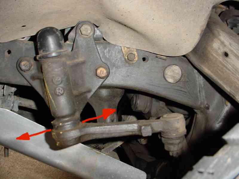

    ....MOT failure Arrghhhhh!!!
    Worn/too much free play in the said item (maybe not a surprise in a 10 year old car). See attached photo for the worn item.
    Any ideas if the 'rod' or 'sleeve' part is most likely to have worn?
    BTW Milners want £95+VAT for this part- can anyone think of cheaper source...

      Its very easy to do a repair job on these. You can buy a repair kit which consists basically of two bushes which go inside the housing.
      Check this link
      http://www.4x4wire.com/toyota/maintenance/idler/
      That should have all the info you need!

        Bushes
        Milners do the idler bushes £2-00p each there a doddle to fit, there only nylon.

          Delboy- thanks for the link- everything perfctly explained!!!
          Bob- just seen them- might as well doo both sides at that price. At least I don't need the metal work!

                    LUCKY for £2-00p each l would do them know if you have been advised about them, otherwise the shaft at the bottom bush may wear in 10 months and you will have to replace that at nearly £100-00p plus vat and delivery.
                    the bushes can be done with out taking all of the idler arm off.
                    Live Life To The Full
                      I had to buy a whole idler arm because the shaft on mine had worn down so much, the bushes wouldnt work, andd the balljoint was gone too! Cost €180 ! Best to take care of them asap Lucky!
