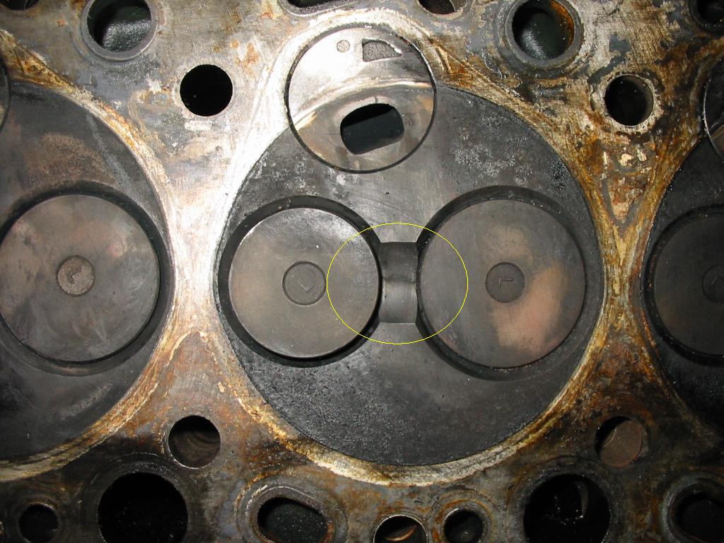

( cheers Morr) I have finally got the head off. The gasket has definitely gone - 6mm gap between pots 2 and 3! There appear to be hairline cracks on the circular discs where the injectors fit but not elsewhere on the head. Are these part of the injectors or separate nozzles/ seats? Can they be replaced separately or will they not need replacing?

(dont ask how much) I fitted genuine new head from toyota to mine, it came naked!!!!!! you can tap them out fromthe rear with the injectors removed and then knock new ones in to replace them, however it does not seem to make any difference if they are cracked or not so long as the head is not. You wont miss the cracks! usually between the bores on the head. Mine was caused by a bad radiator! it had lost most of its cooling fins so the head just got too hot towing a caravan over the pennines. There are also a number of differing thickness head gaskets if you go to toyota! they are marked by notches in the gasket, not an option with the cheap replacments

it was quite badly warped sooo was skimmed down by 22thou and this then required the valves to be reseated 22thou down. I had already bought the gasket set so they also fitted the new oil seals on the valves and gave it a thorough clean and the whole job including the pressure test and skim was £150 including the VAT. I think this was very reasonable so would recommend their work.
