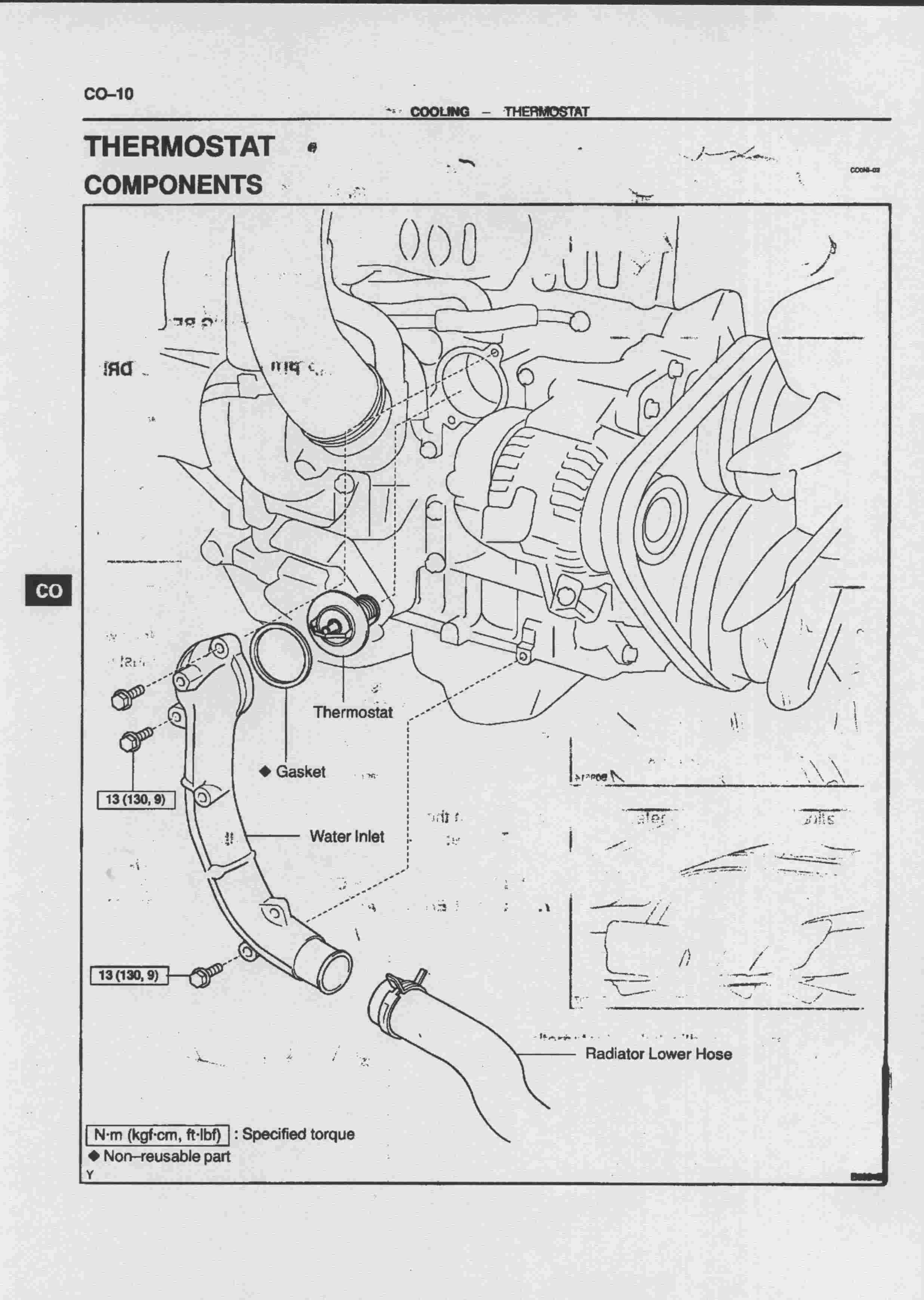

    On the advice of you chaps, I've bought a new Toyota stat and rad cap for when I change the rad. I understand I have to remove the old stat to flush the system. Where is the stat?
    I dont think there is anything else I need to know, but any other snippets of advice are all welcome.
    Its down the left hand side, in front of the turbo.
      Here is a useful diagram that should help you out. You can see where the thermostat is, in the top left hand corner. Follow the hose, and find the stat.
      Hope this helps???
        This one shows the location.

            Try to remove stat housing for 5 minutes, then realise there is another bolt in the casting about a foot lower down... (note to self - look at the diagrams boy!)
