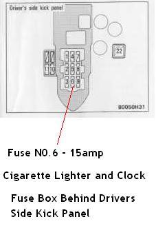

    iknow this one is a little lame at this time of night, but my cigarette lighter isnt working and i need it to!! i am going camping on saturday and the fridge only runs fron the lighter! anyone help me out with any ideas?? i dont even know where the !!!!!! fuse box is lol!!

    check the dome fuse, under the bonnet, that took out most of my interior elctrics but i think it might have left the lighter (can rember 1 thing worked that i didnt need to work lol)

        See attachment below

          Thats brill thanks alot!!!!
