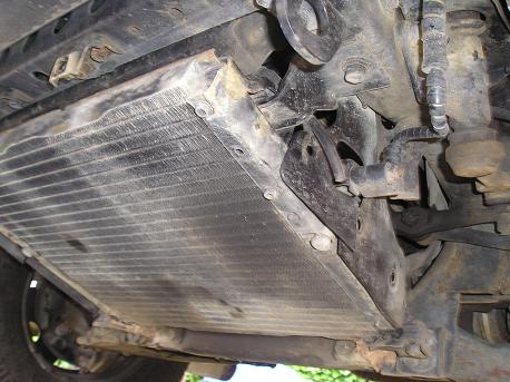

        did you have any major probs with the 2.4td mine has a 4" body lift so it should daft question what is that rad underneath for?

          the little rad? i presume your talking about the oil cooler???,is your surf automatic?

            Little rad is aircon rad
              its not a little rad its almost the same size as the cooling rad?
                If it lays either behind sump guard or next to radiator its aircon rad.

                  Its the aircon rad, and is gonna a major PITA if you want to get the sump off.
                    Just need to bite the bullet and have the aircon discharged and recharged when you have finished the engine. Only 2 pipes and 4 bolts to take the thing off then unplug two plugs and a small diameter pipe that just pulls off.
                      this is an aircon rad earlier today

                        my air con rad is mounted in a different position to yours so i dont know what its like to take off

                          Some AIRCON RADS are fitted in front of your main Radiator.
