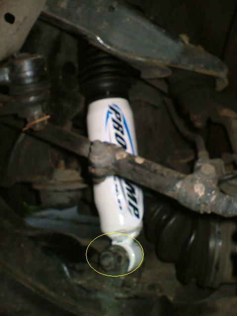

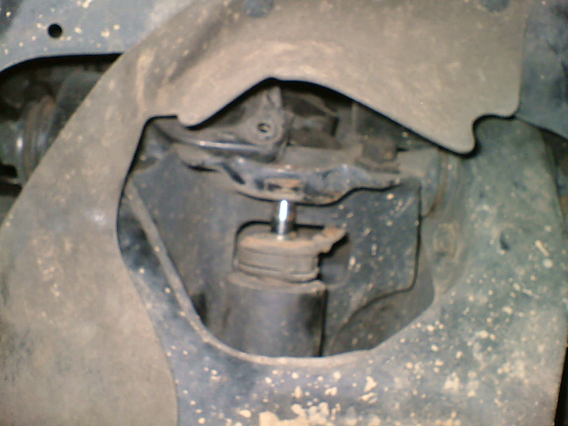

I had been spraying the 22mm nut at the bottom of the shocks all week with WD40 and found them real easy to remove.I left the bolt in untill i had undone the top nut as this can spin.

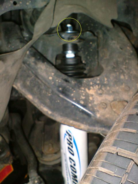

Then i removed the top two 10mm nuts holding on the adjuster cap. Just move this out the way and undo the top 17mm shock nut.And hey presto the shock should just slide out.

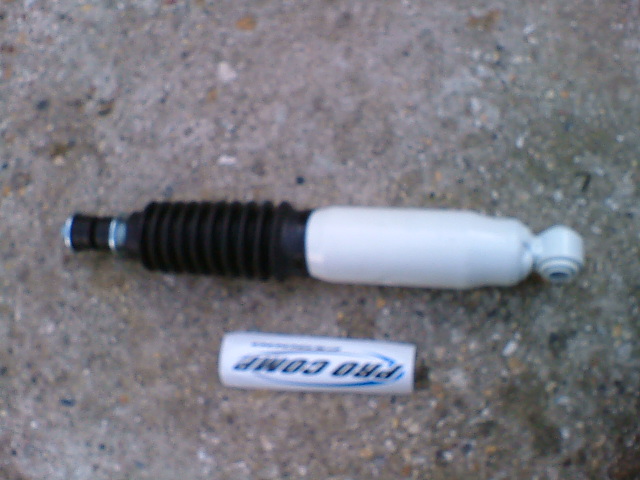

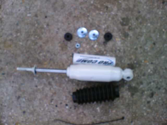

I took a picture of the front procomp 9000 as it came out the box and then again assembled . This was the bit tony helped me with just wasnt sure how the rubber bushes and metal caps went.(im new to this car maintenance lark)
Slide the new shock up through the top mounting hole and make sure there is a bush and cap either side of the mounting hole then tighten down the nut to the end of the thread.
The bottom bolt was eased in and then tightened .
