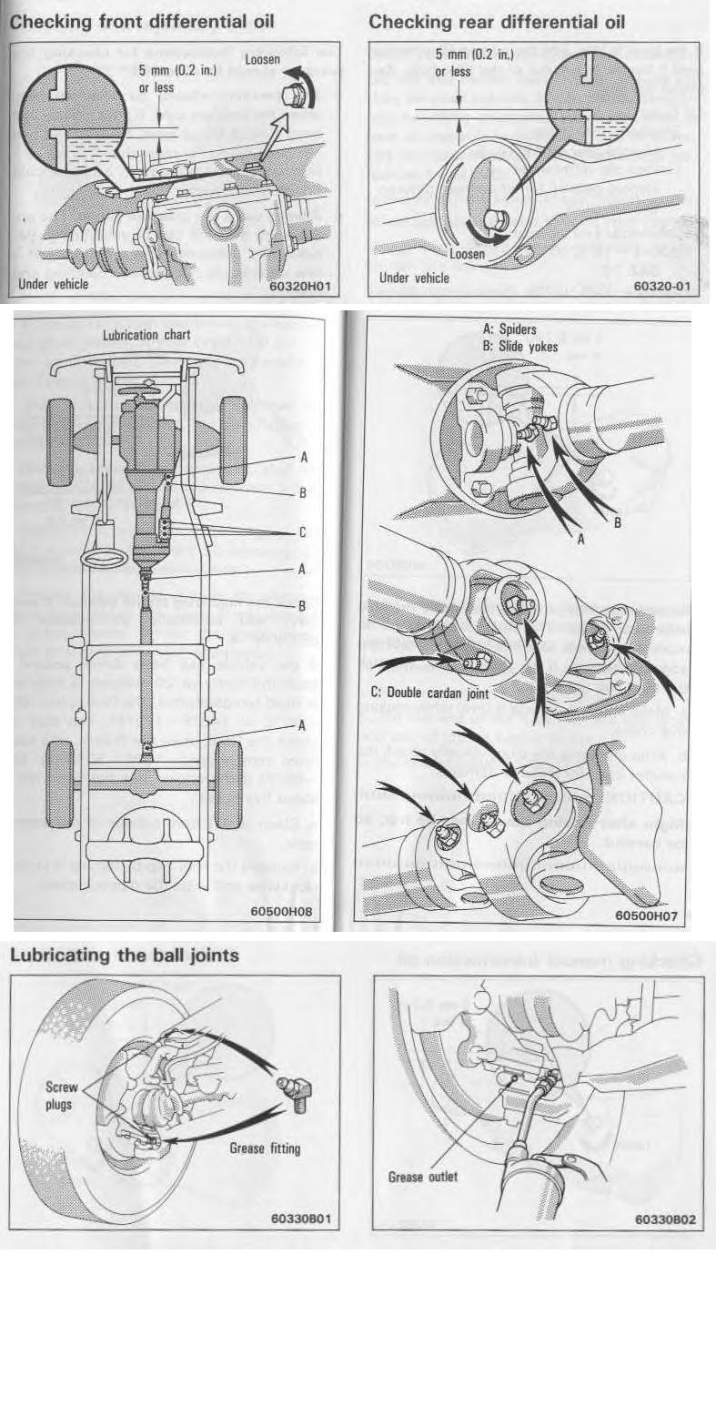

    You have just about got the lot apart from a good grease round. The attachment is a list of grease points. If you still have the Toyota bottom ball joints you will find 2 6mm plugs in place of the required grease nipples. You will need to change them for 6mm either 45 or 90 degree nipples. There are lots of posts on the Forum that lists the service schedule for the Surf. If your Surf has been off road a lot the grease points are about the most important otherwise the ball joints and steering linkage suffers from ingress of mud/water.

        After my recent experience with hot front disks- I'd be inclined to renew all the brake fluid too. Bleed out all four corners to flush the cr*p out the pistons. Ten minutes well spent.
        Dip your finger in the front and rear diffs too to see if they need top up/change.
