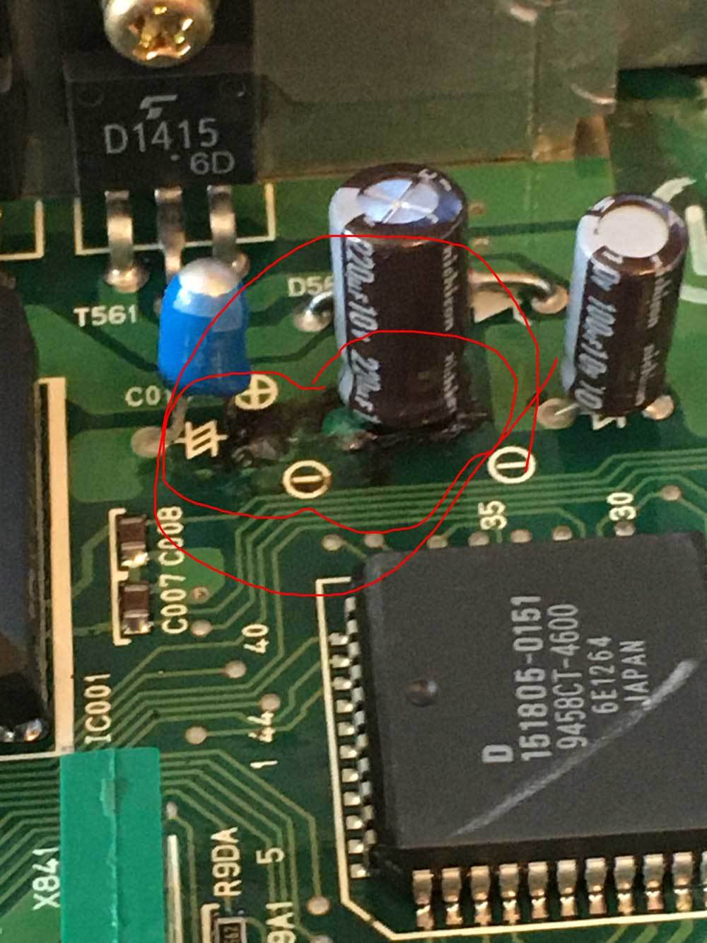

    SOLVED (fingers crossed) ECU was the issue.
    Sent the ECU off to ECU-Doctor in Devon, replaced all capacitors and a few other components that degrade with age, and all seems good. £200 + VAT and a very good service from start to finish.

      OOOH - took teh ECU out and there is a leaky capacitor - see picture - now... any recommended ECU specialists?Click image for larger version

        Try ECU Doctor. Link on the banner on the home page.
        Thanks
        Rob Watson (forum owner and admin)
          As above, the same symptoms I had. Capacitors in the ECU were leaking.
          ECU doctor or TV repairman will sort it out.
