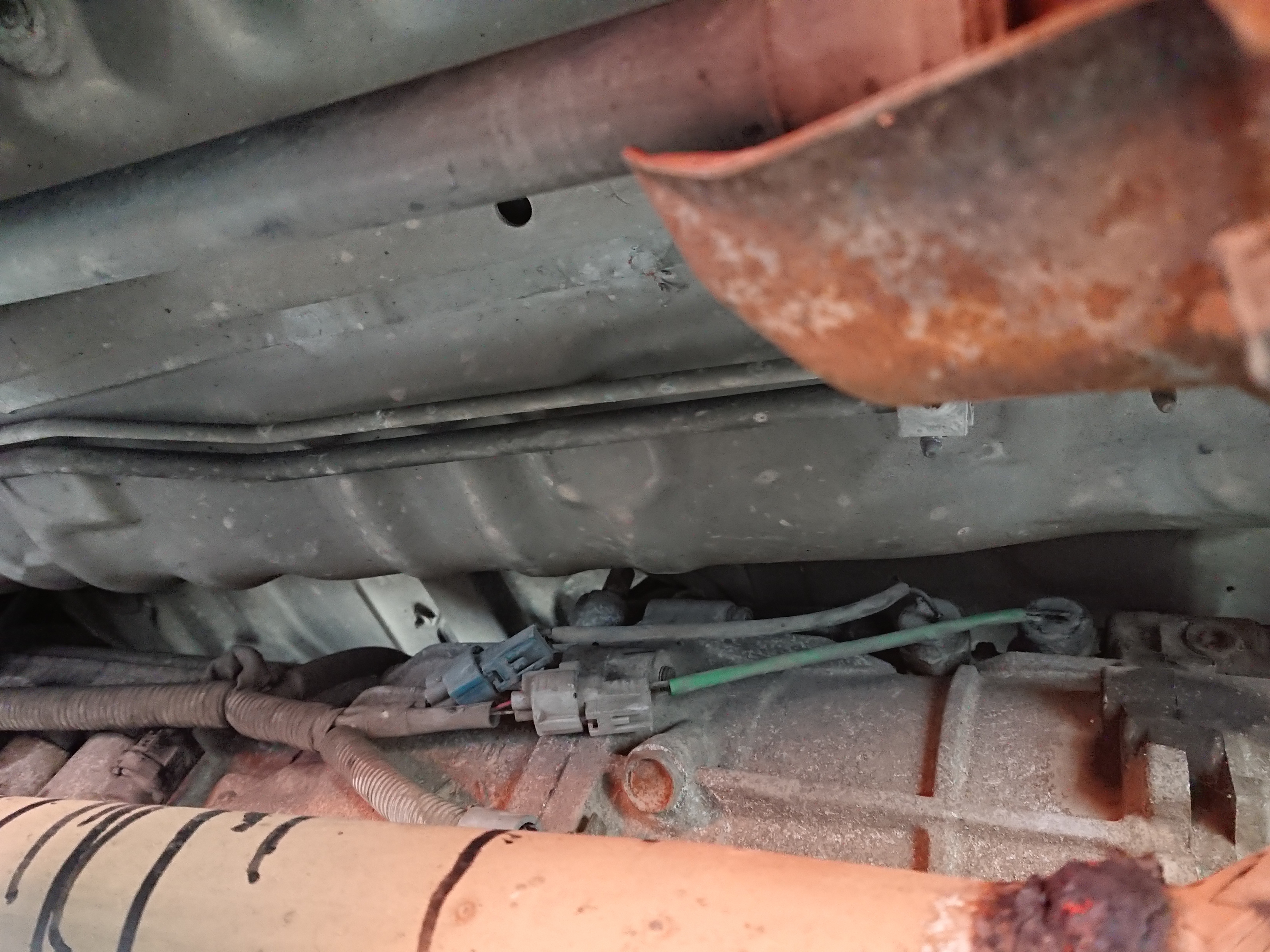

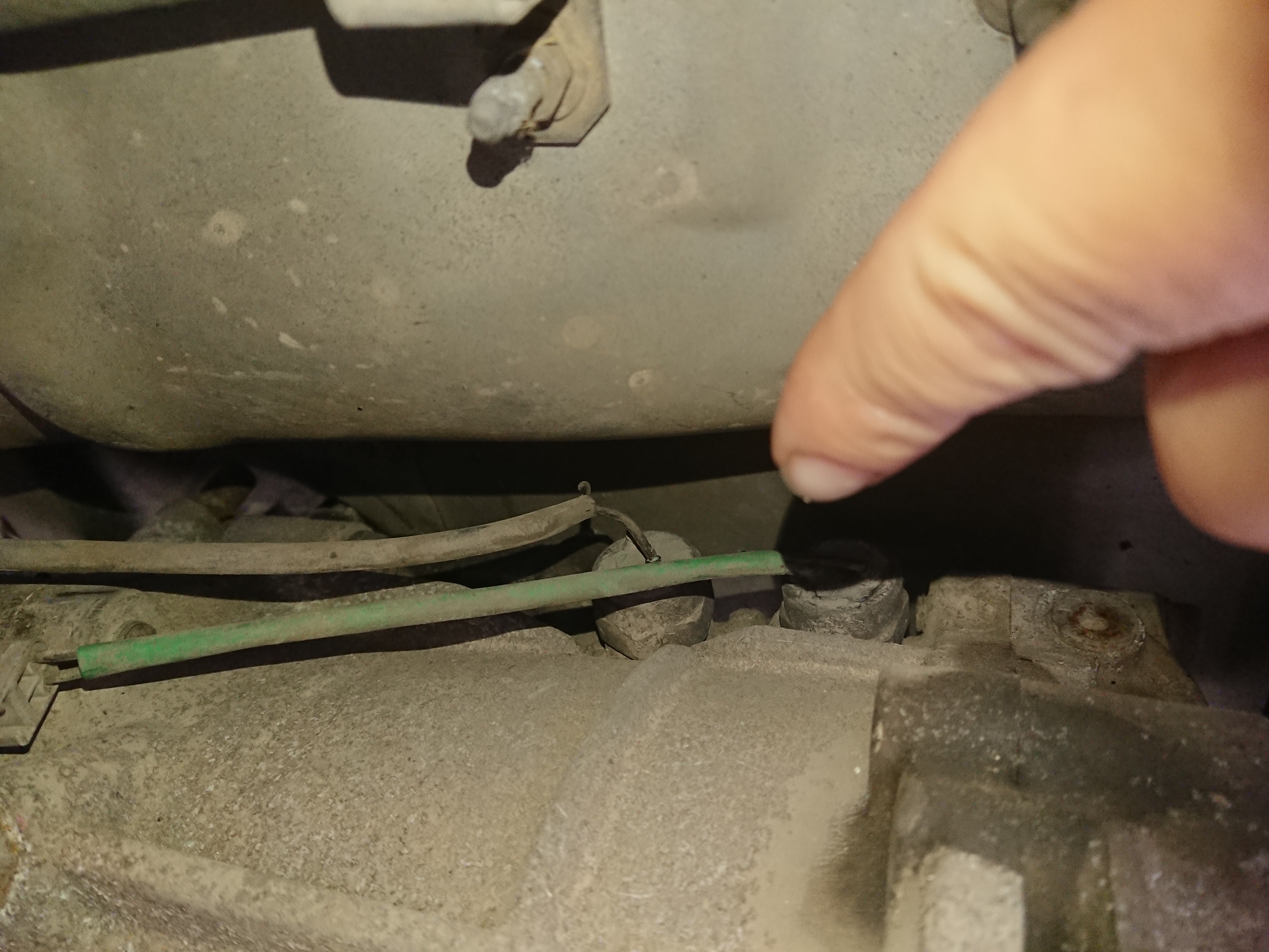

    Hi, i've been following the site for years, I did post in the newbies bit to say hello... Unfortunately the time has come for me to plea to the surf gods for abit of wisdom... Can anybody tell me what these to things are in the pictures? I have found a snapped wire, and im already working Click image for larger version

    Anyone? These are toward the back of the gearvox and on top right under the floor pan. I already hace fault codes 62 and 63 which i know are shift solenoids (trying to find ones that arnt toyota at £215 each, cheaper to import from the states and i may have found somewhere on amazon, once confirmed i will post link here if i can/its allowed).
    I just want to know if this could be giving me the shift solenoid fault code in the ecu. I have replaced the ecu with a checked one. As mine had blown the caps over the board...

      Hi Bob,
      Almost certainly. See http://jp-carparts.com/toyota/carlist.php?maker=toyota to confirm part numbers of those bits (though sounds like you're already on track with parts)

        The front one is the Lock-Up solenoid, the back one is the Number 1 solenoid.
