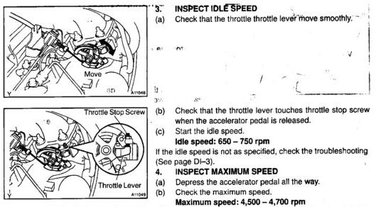

Is is possible to adjust the idling speed on a KZN130 engine or is it controlled by the ECU?
Mine idles @ about 800rpm and I get a bit of thump when I engage Drive, was thinking of reducing the speed to 650 maybe.
