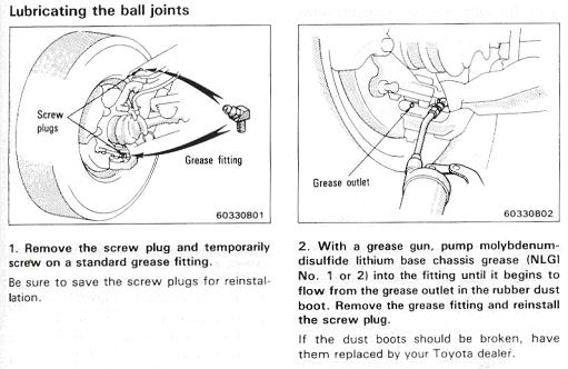

I can hear a loud squeaking coming from behind the right front wheel (no, not a mouse). I can hear it when I am driving along, it's worse over the bumps, and also when bouncing the Surf when it is stationary. I have tried WD40 on various moving parts with no luck.
I noticed that there is a black doughnut type rubber part on both the left and right (see photo) and that when I prod the one on the "squeaking side" I can hear air coming out, but that this doesn't happen on the one on the other side. Could this be the cause of the problem? Oil or something may have leaked out? If so, how easy/cheap is it to fix?
