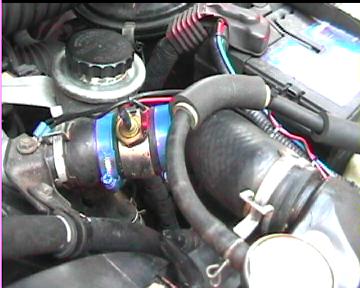

                Deemontweeks do an adaptor which cuts into the top hose and takes a temp sender. This seems to be a good option and easy to fit.
                  Just seen this post and Think this is what you mean? bought from Demon Tweeks!

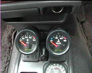

                  The gauge on the left is a transmission oil temp gauge plumbed by means of a tee into the transmission output line before the inbuilt rad cooler. Iv'e been running this setup for a couple of years now and learnt a lot about these temps Also run 2 additional transmission coolers plumbed in series after the inbuilt one !

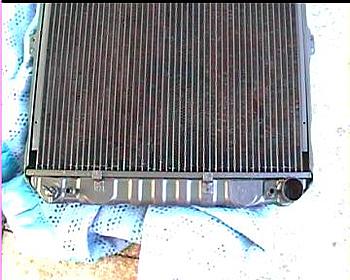

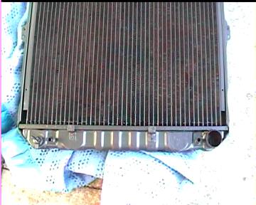

                  Just done a rad mod together with a new replacement 4 row core! not warm enough to test under load yet (tow a big twin axle caravan) but the theory seems right having seen some excessive water and transmission oil temps towing this summer!
