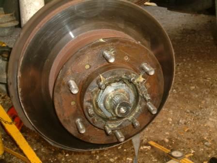

                  Sounds similar to mine. It could be the brass bushes that align the drive shaft at the hub end. Look at the brass ring close to the splined end at the end of the hub in the first image, inside the wheel bearing bolts.

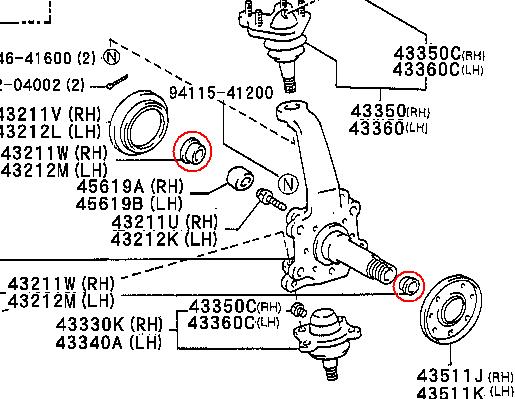

                  Bushes, outlined in the second image...
                  Part numbers taken from EPC for a Nov 1991 LN130W...
                  90381-30003 8904 - 9708 Bush (for Steering Knuckle RH)
                  90381-30006 8907 - 9708 Bush (for Steering Knuckle RH)
                  Of course, that would assume that the bearings are all set to spec and don't need tightening... and also assuming that this is exactly the same as your condition.
                  HTH, andyL
