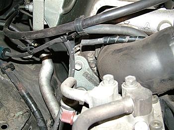

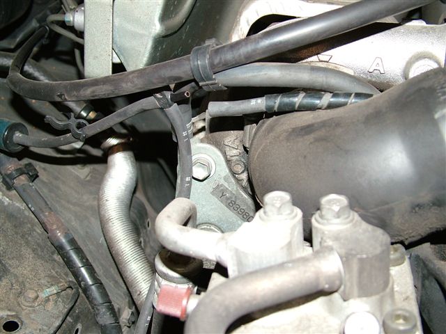

Make sure the pipe under the butterfly/throttle valve on the inlet manifold is on ok and has no splits in it, it's an easy one to leave off, I put a jubilee clip on mine as the end was quite perished
