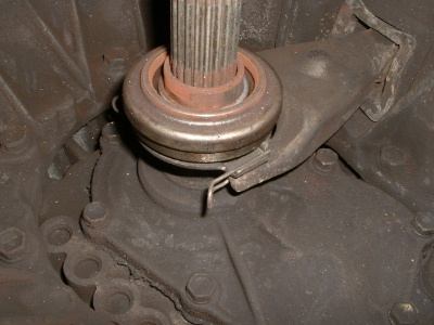

              You have your release bearing moving up and down the shaft okay? The fork moves the bearing and is visible on the outside of the gearbox at the slave cylinder. On the inside end of the fork, it is held onto the release bearing by a spring clip which, as the fork throws the bearing forward, grinds on the back of the fork.
              You'll have to live with it if you have it, unless you can get the boot off and surgically spray some grease onto the back of the fork. Gotta be hard to do right coz you dont want grease going the wrong direction in there. I had my box off and was able to lightly lube the input shaft/bearing & spring and the squeaky clutch is gone since.
              Pics were surely taken....heres one from inside the bellhousing, you see the spring and the fork but its underneath the fork where it squeaks
