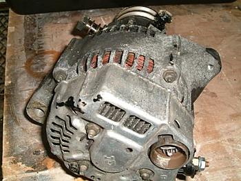

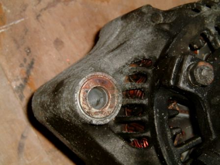

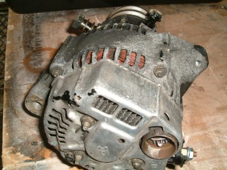

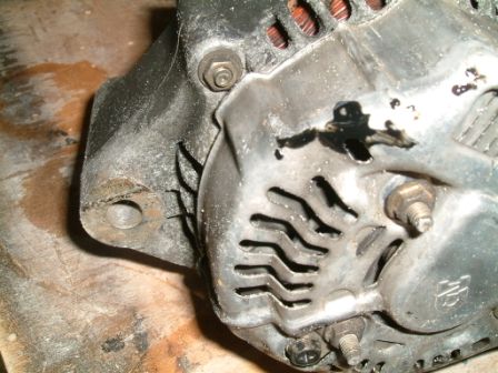

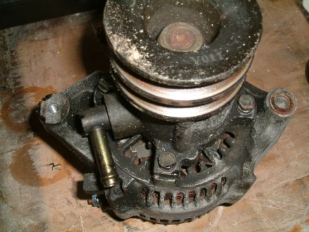

              NiftyNev,
              saved you the bother. See images attached. You are absolutely right, although it looks like it is just a large washer pressed in... maybe machining it out and replacing..?
              Blue,
              If you need another alternator, I have my old one, but it will need rebuilding - as you can see this bush appears to be complete and when tightened didn't move around. StreetlugeChris or Hilux Bob will also likely have some knocking about.
