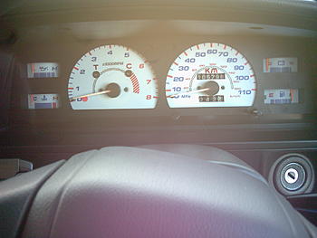

    Hi Paul
    You can cut holes in them. I did with mine...Just do it carefully !!!!
    I also altered the speedo and tacho to read correctly for diesel vehicle.
    (search my previous posts) Finished glo guages look good when fitted.
    John

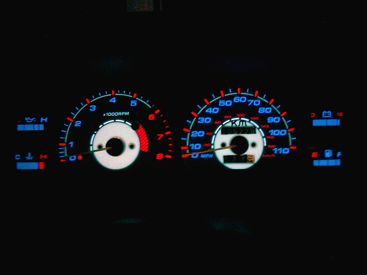

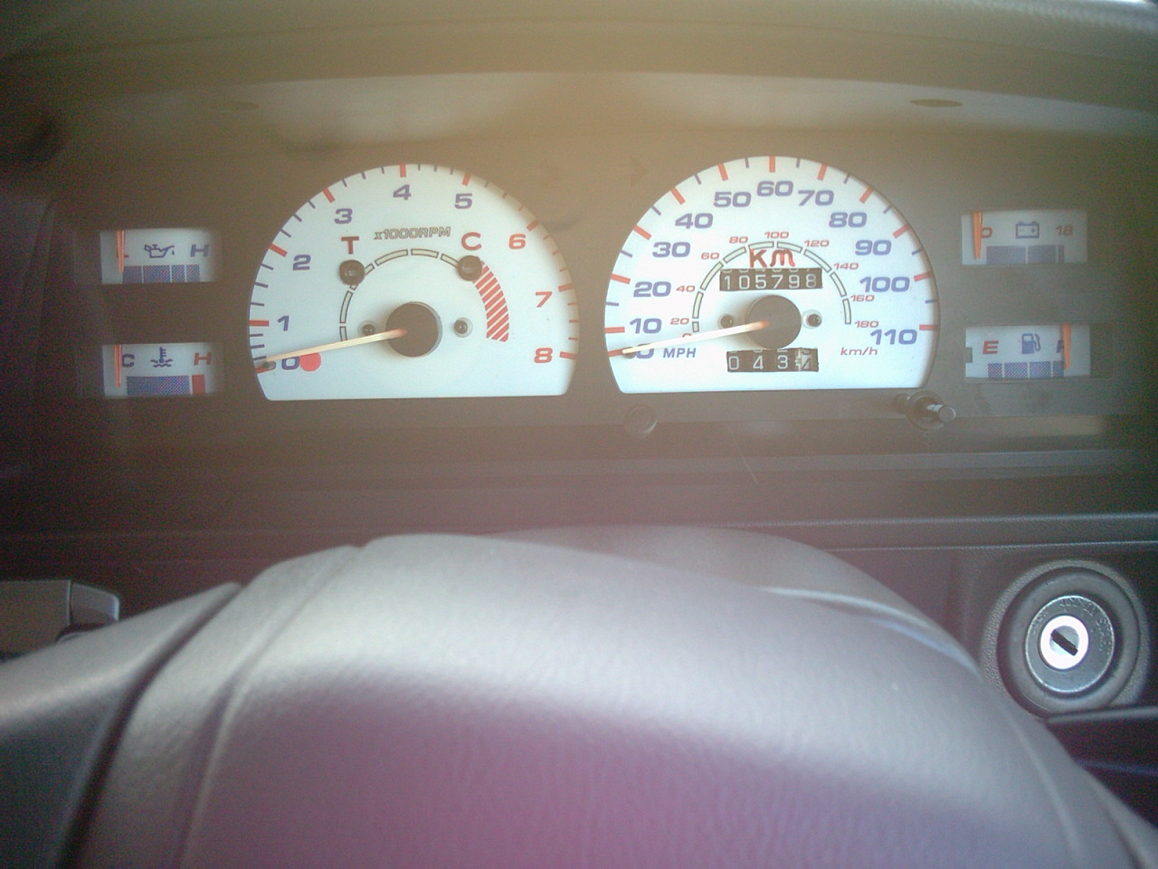

        Hi, I have fitted these Gauges and it is possible to cut some small holes in for the Turbo & Engine check lights just be very carefully also I put a small washer over / around each cut hole to tidy it up. Have a look at pictures attached.
        Andy.
