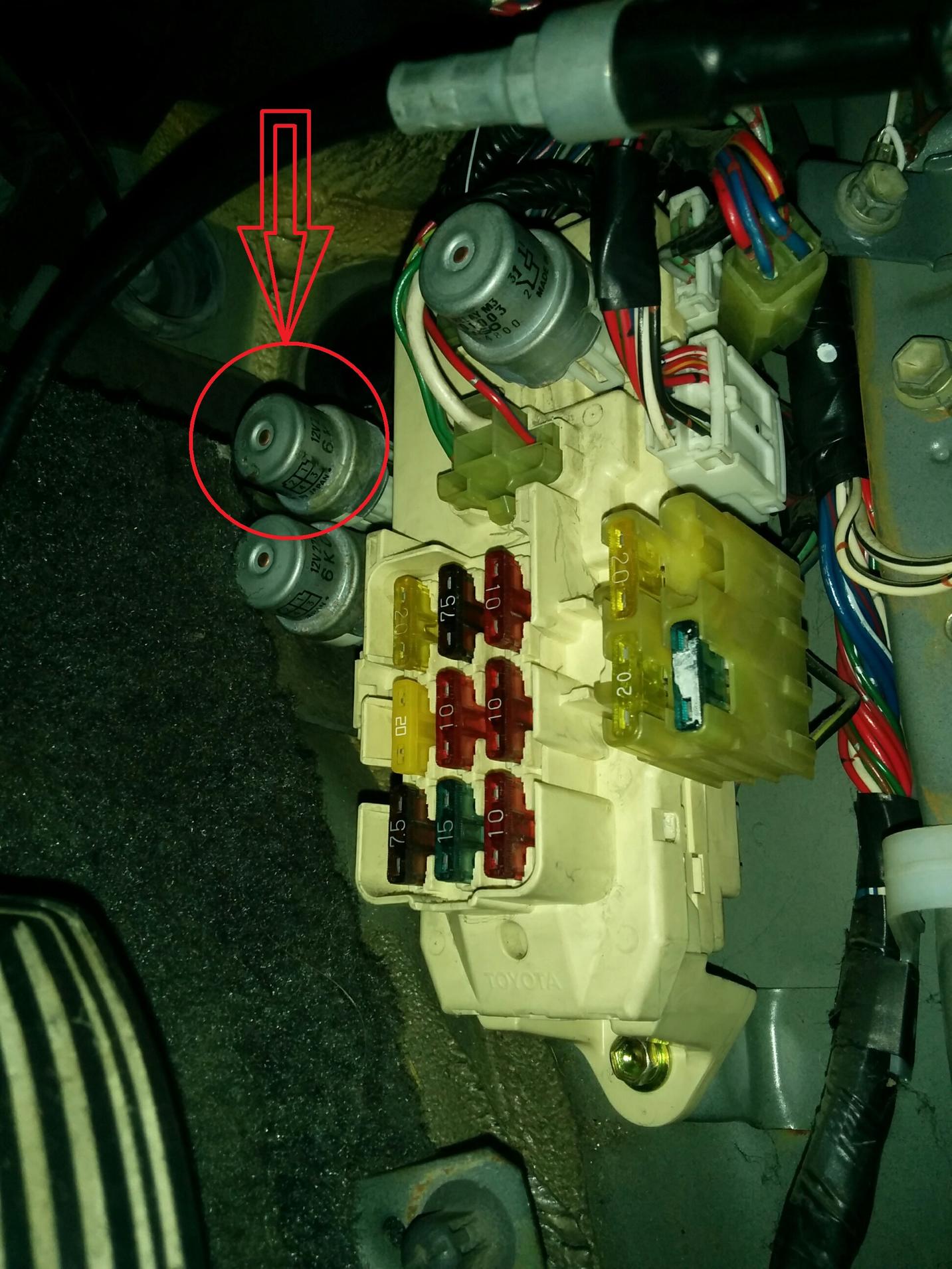

          So my problem still persists and I was towed home on Friday. One of the relays heats up so much its almost too hot to touch. the relay is beside the fuse board in the drivers foot well. the upper forward most relay.
          so there must be a short circuit somewhere. Also when the hilux is turned off and the key is not in the ignition, i can feel and hear the relay switch on/off as i put it in and out of its socket.
          Any one any ideas on where to first look for a short. Also does anyone have a wiring diagram?

              After doing some more fiddling last night, I found that if I wobble/shake an area of wiring and the thing shown in my hand (shown in the photo), the short will intermittently go away. However, still wont start.
              By the way what do I have in my hand in the pic? it just beside the alternator.

                As far as I can see that relay should be for the sunroof according to the EPC. Is there a part number on it?
