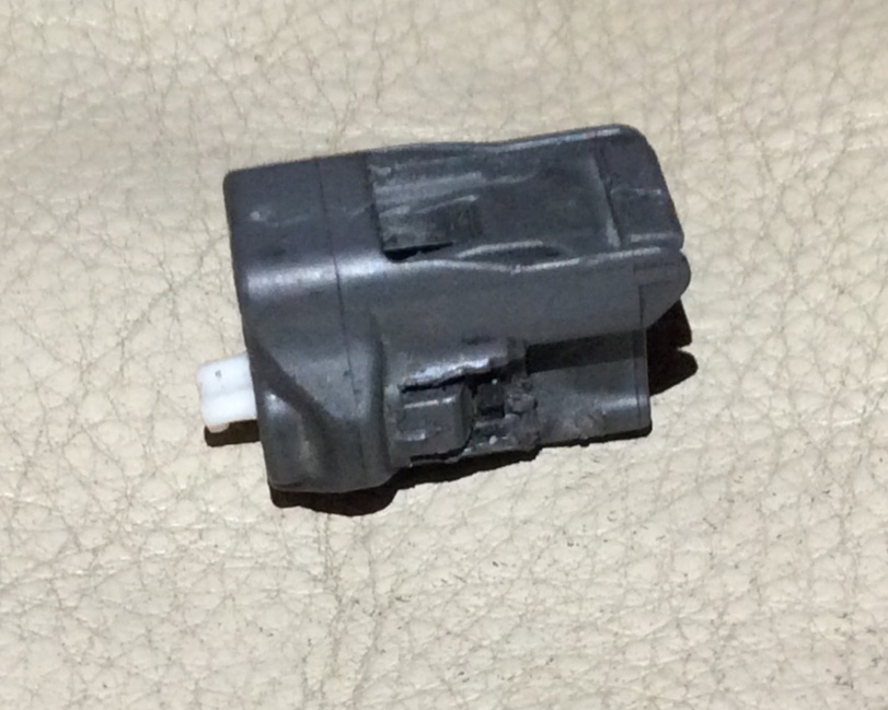

                    No Nev, no numbers on it at all. If I can get adding pics to work, it looks like this,
                    Ignore the little white thing sticking out, it's not supposed to, I was trying to dismantle it to try and rewire it

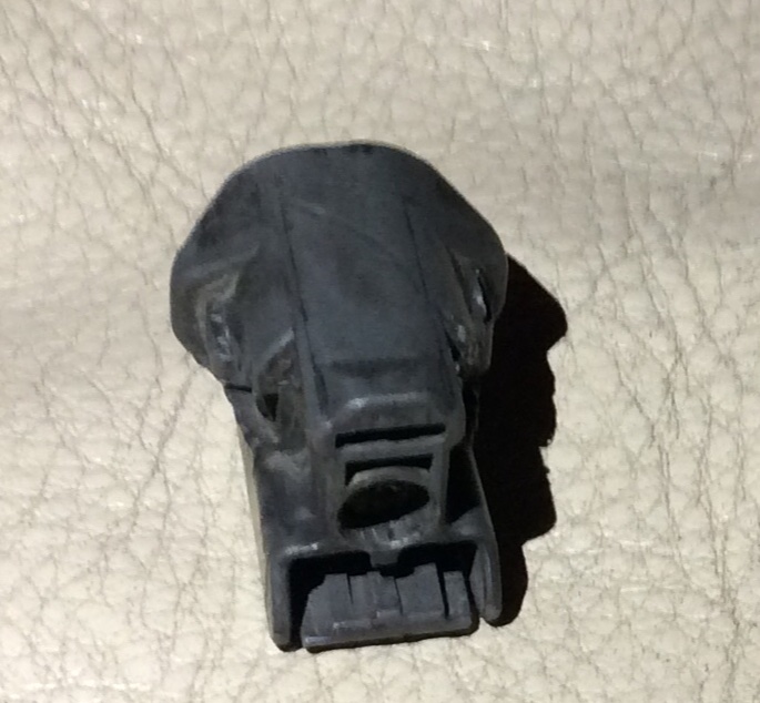

                      Another pic

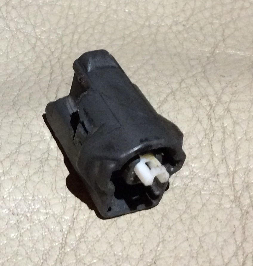

                        Last pic

                          See if you can match it to any of the diagrams there. If you can, it will have a part number. Google that part number. I think all Toyota connectors start with the part number 90980-. Some connectors have the last part of part number on the connectors. Let me know if you find a diagram. I'll have a look tonight.
                          Nev.
                            Thanks Nev, if I'm looking at the right part, I think the number is 90980-11243 housing connector female
                              Looks like that one to me. Wide keyway on right, narrow keyway on left, with flat of connector up. Looking for the correct terminal now. The centre part you have pulled out locks the terminal in place. This has to be out to install terminal and wire then pushed in to lock. It will come out completely if you pry it in the correct way.
