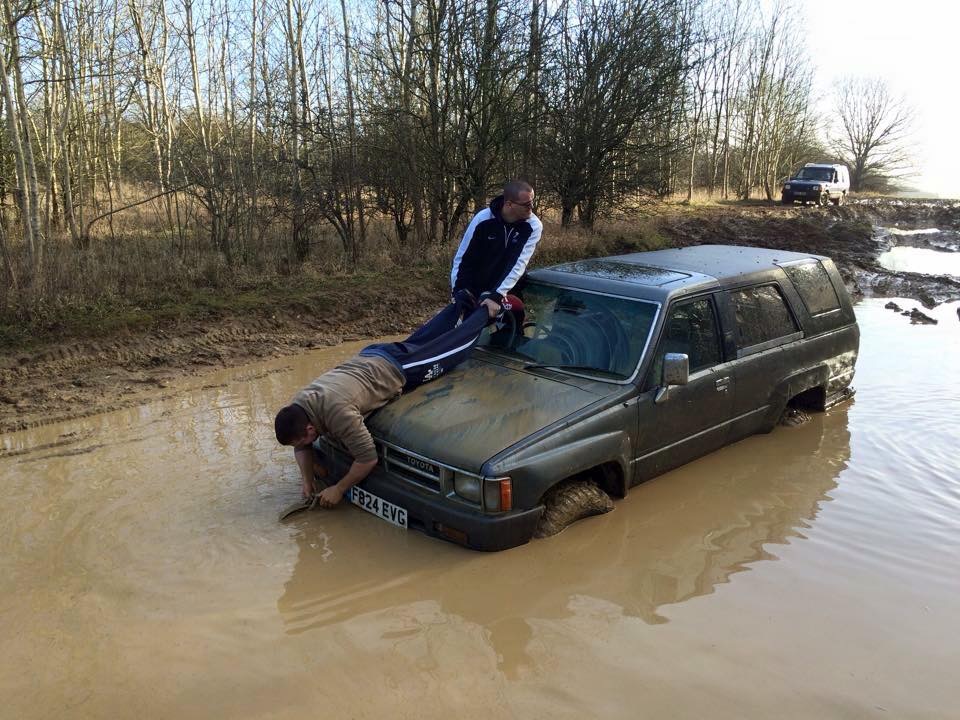

    So up on Salisbury Plain I got a nasty surprise and a bow wave that flooded the intake (no snorkel). Engine is a 1st gen 2L-T
    I was with a bunch of guys so managed to get it towed around in gear with the glow plugs out and get shot of all the water and luckily she started again and ran all day. Seems to be intermittently only running on 3 cylinders now so the advice needed is:
