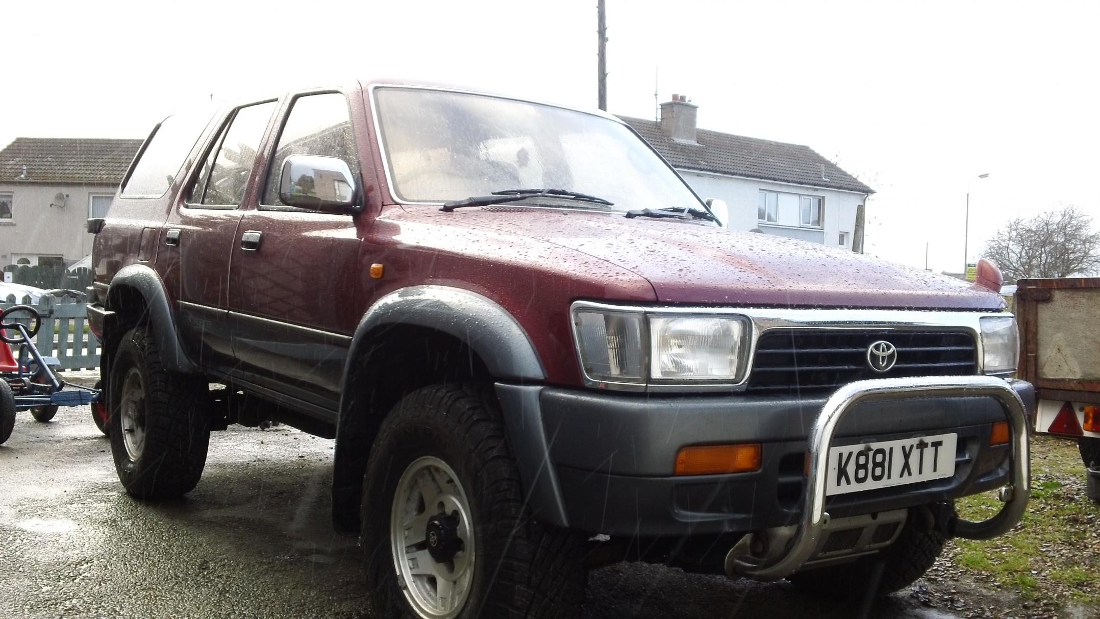

                      So, new springs fitted, bit surprised at amount of lift, but drives very nicely...
                      Before:

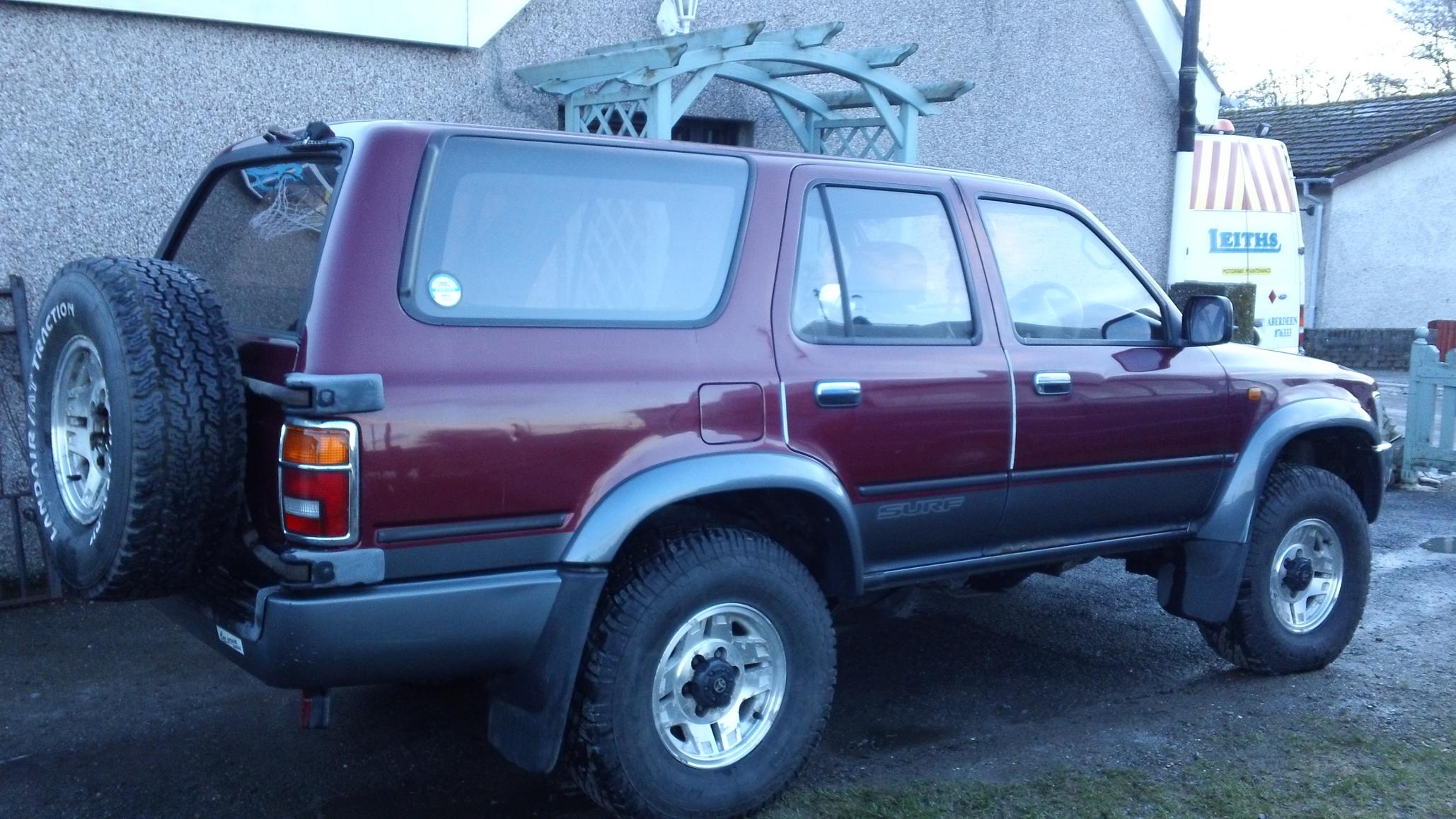

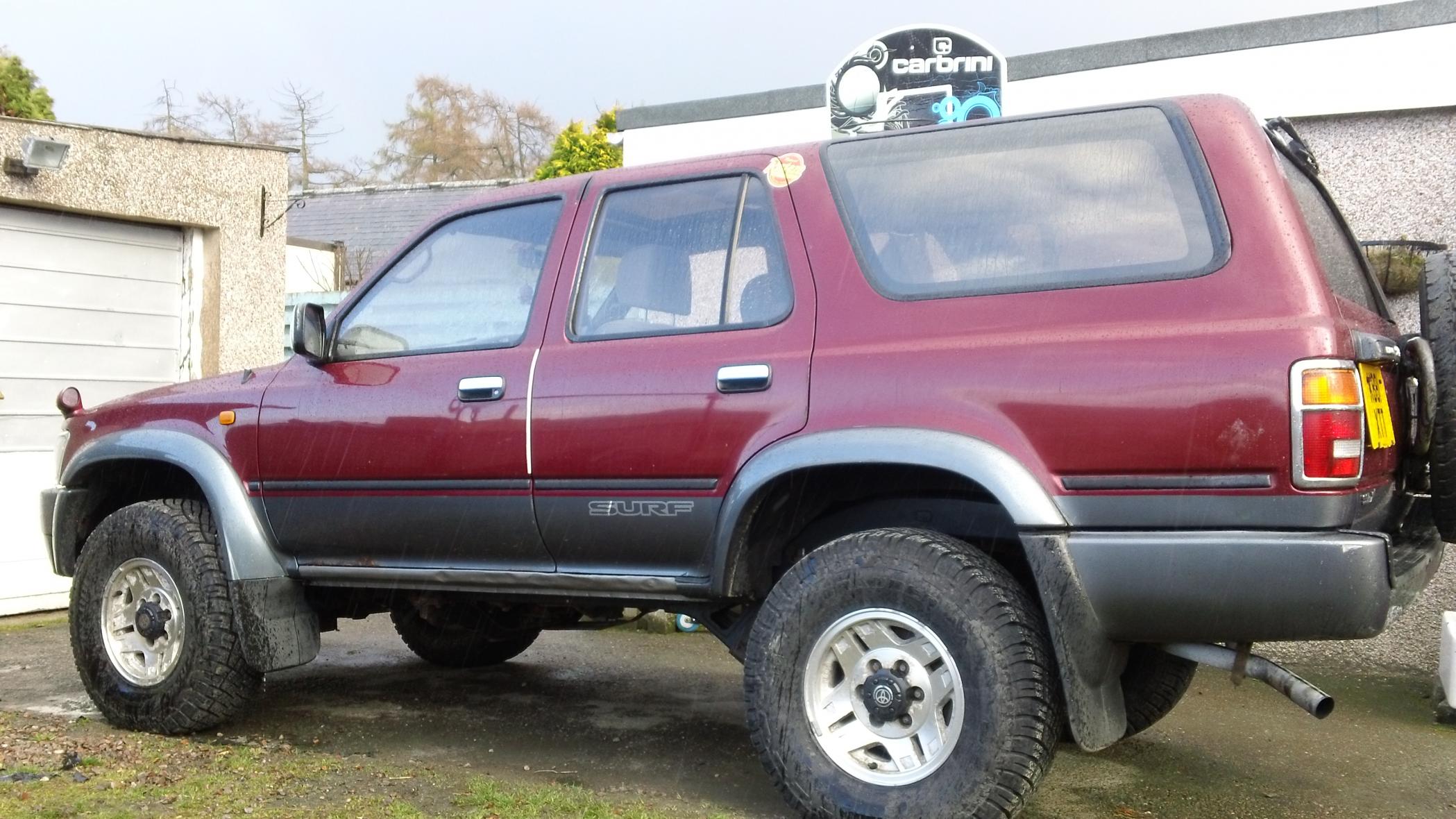

                      And after:
                      My Mrs is 5' 2", getting the shopping in the back may be an issue!
                      Cheers, Ron
