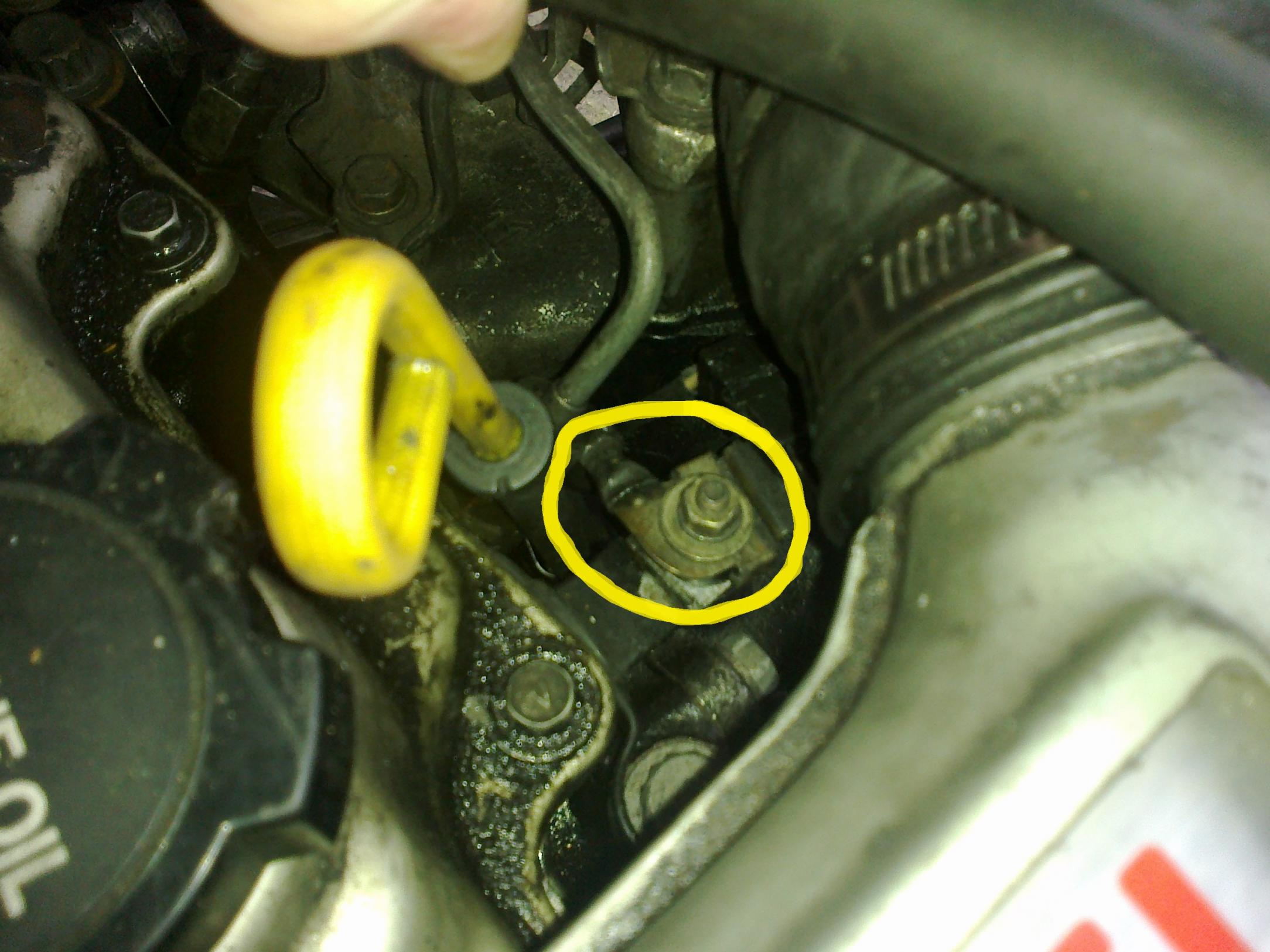

                        Easy done really, if you don't rebuild the bus bar insulator in the
                        correct order, all you have is a dead short.

                              Replaced the 80 amp fuse, connected the batteries and the fuse blew again, I've obviously connected something wrongly. I've attached a pic of the stud that the insulators and power supply attach to (circled in yellow), does it look right or have I got it wrong?
