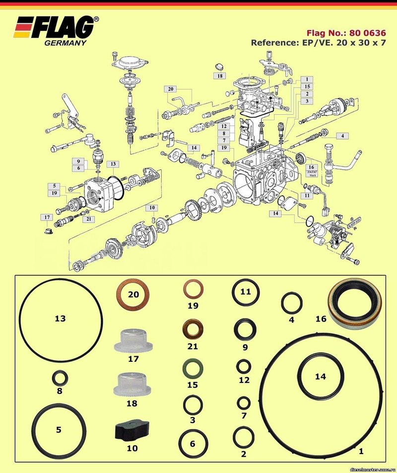

When first started from cold the truck has a constant dribble of fuel from the fuel pump.
When it is warm this slows down.But never stops.
As it is not leaking from the top seals and the leak is evident running down the font and eventually over the steering damper and front diff electrics, would I be correct in assuming that the leak is from the fuel pump shaft seal?
Do any of you know? ;
Seal size or part number?
Can this be done in situ without removing the pump.
One assumes that with the pump sprocket and woodruff key removed you would be able to pick it out?
Ta
