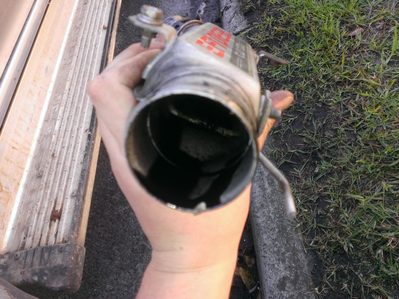

    I have tried to determine the problem myself working currently on the air intakes, I have found oil build up in the air intake hose running to what I believe to be the turbo.

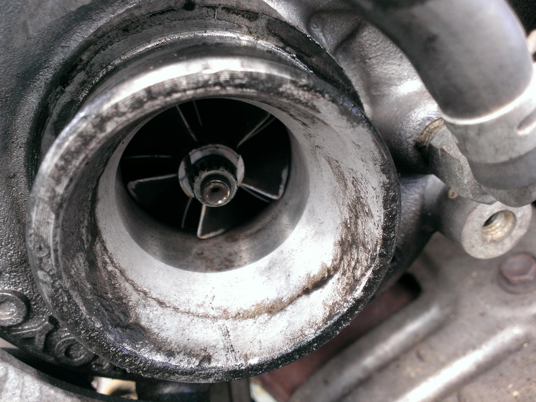

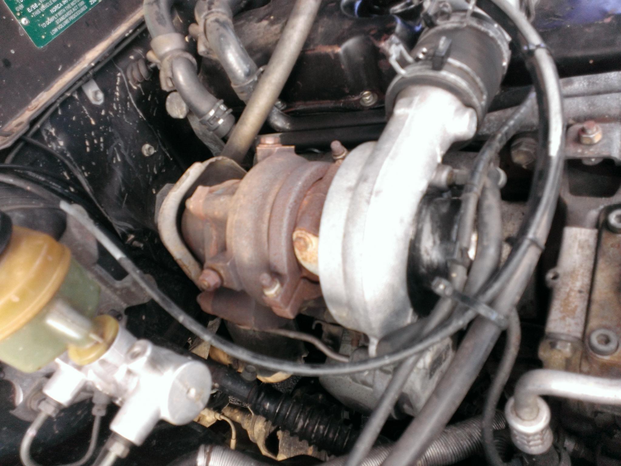

    Just to add a few photos of the turbo as I have been suspicious of its part in this
      those compressor wheel tips look like they have seen better days.
      i would fit a boost/vac gauge on where the boost sensor is (ie directly to intake manifold). if your reading vacuum at idle then you have a problem with intake butterfly, turbo or an intake blockage. low effective compression will cause white smoke.

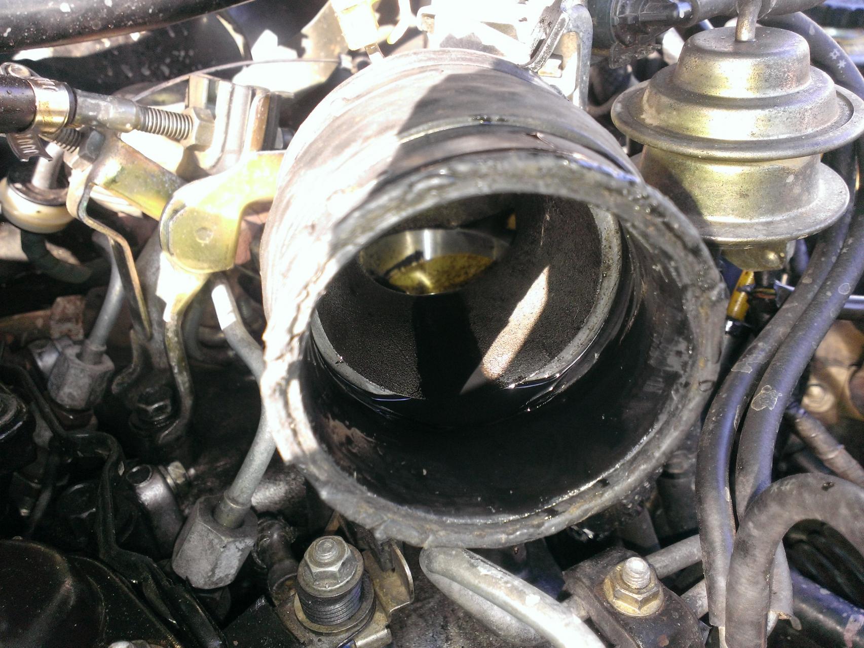

        intake butterfly
        One of my thoughts was something to do with airflow, except I'm not sure exactly where the intake butterfly is to look at it, sorry im still fairly new to this, and how to access it
          follow the intake pipe from the turbo to the intake manifold. you will see throttle cable connecting.

                      Butterfly
                      Following the intake manifold, asside from finding a crack in one of the rubber hoses, found a bit of an oil trail leading into it
